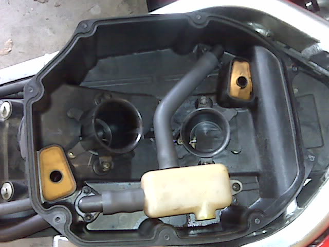

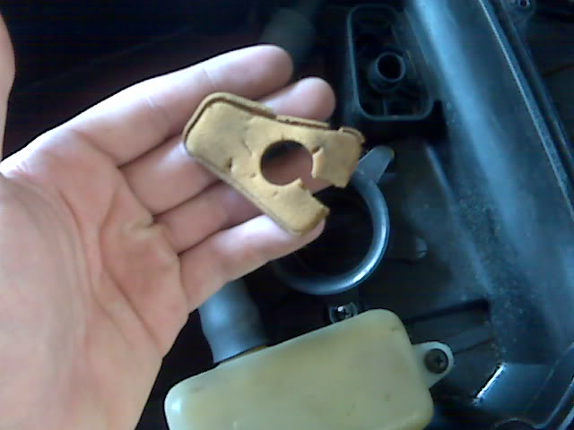

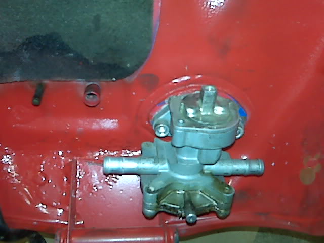

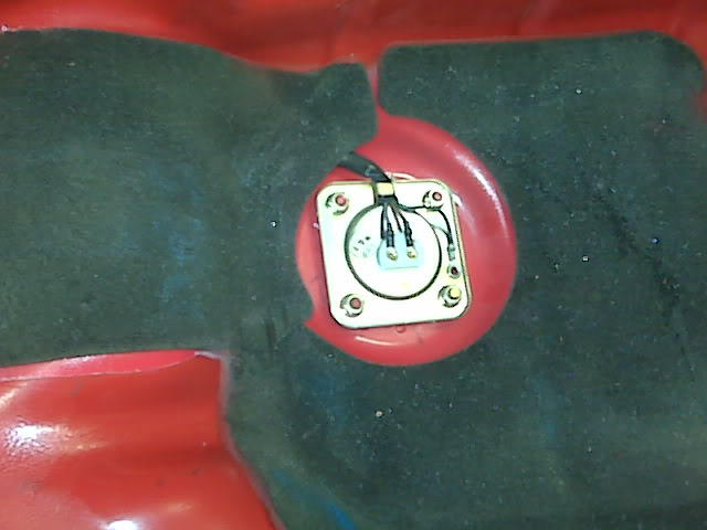

Pic1
Pic2
Pic3
Pic4
Old Jun 21, 2009 | 12:04 PM
pzurek18's Avatar
Posts: 83
pzurek18 is on a distinguished road
Alright guys is #4 the petcock DiaphraM? and also does number 3, that being ripped will it cause any problems while riding?
Ok guys all the lines seem fine and the vacuum line is not on the downwards third nipple i put it on the one behind the bigger hoses.
What else do you guys think? i didnt see any rips the only thing is a still dont know if i have a "torn diaphram"
Thanks guys hopefully the pictures help
Old Jun 21, 2009 | 12:08 PM
Originally Posted by pzurek18
Hey guys i have a quick question, i took off my tank just now and i had to the two big hoses one on each side, and then the really small thin one was on the Right side and there was the little nozzle pointing down, what my "vacuum line" on the wrong nozzle? because the one pointing downwards was leaking a little bit of gas when i was taking it off. Sorry for the squid Question but i just dont know the name for all the nozzles
It goes on the one pointing right, the one pointing down is the vent to allow the diaphragm to get air on the back side.. And if that was leaking fuel, it is likely that your diaphragm is torn or damaged.
Old Jun 21, 2009 | 12:09 PM
#4 is the fuel sensor.
The diaphragm is inside #1.. you have to take the petcock apart to get to it.
Old Jun 21, 2009 | 12:11 PM
nath981's Avatar
Posts: 2,934
From: altoona, pa
no, #4 is the low fuel sensor and the rip won't hurt anything if put back carefully. The petcock diaphragm would be in the petcock.

Old Jun 21, 2009 | 12:46 PM
When you look at your pic #1 you see the petcock. The side opposite of the one shown in the pic is where the diaphram lives and you get to it by removing the 4 screws

Old Jun 21, 2009 | 12:48 PM
You should also replace the foam filter in pic #3. That is where the carb pulls in air for the back side of the slide and with a bad or torn filter you will be pulling dirt and crap into the carbs...
