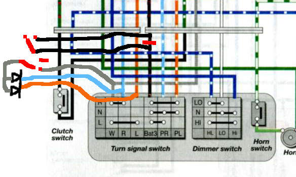

The reason that doesn't work is the front running lights... If you look at the wiring schematic, you find that the handlebar switch connects both the signal wires and the opposing running light for left and right setting, ie one remains a running light, the other is flashing on/off... And neutral switch means two running lights...
So, you either do what's described in the mod above, wire in both rear signals using diodes, and let them power the front as the bike is switched off, meaning the switch position is irrelevant...
Or, you re-wire the signals at the handlebar switch, adding a few wires and diodes, and add a swith... Then you set the switch to neutral, and hit that switch and you have hazards...

Old Aug 20, 2013 | 02:17 PM
Thanks tweety, I was wondering about the turn sig switch since yeah it controls them both.
Will mess with it more today. I was trying to avoid the stern to bow wire run but it may be the lesser of the evils to get this done.
Two diodes to keep from cross powering, a dual switch and a couple of wires...
The dual switch disconnects the running light, and connects the flasher relay to both sides in one setting, the other restores the running lights, and disconnect the hazards...
The three to the signals should work with spliced on wires, the black wire needs to be cut and extended...
Simple and requires very short cable lengths, as it's "local" to the handlebars/cluster region... Should be able to put the switch around the cluster somewhere...
This works as long as the ignition is on, disregarding the other light switches and whatever... Engine running or not, or the position of the stock turn signal switch is irrelevant... The downside is that you can easily drain your battery...
