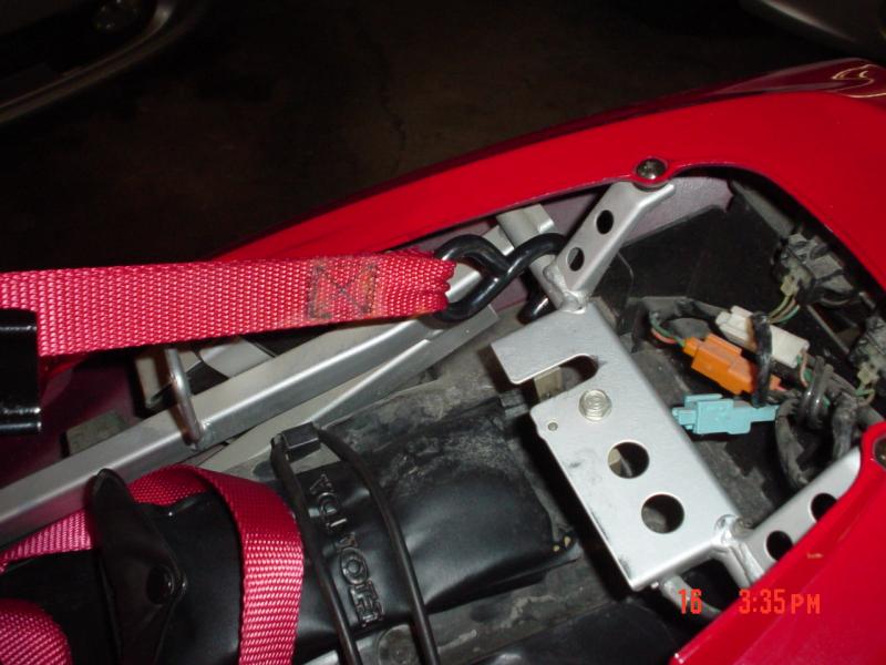

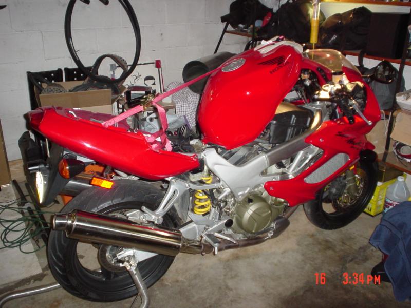

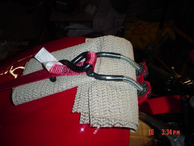

Sweet! This trick saved me a bunch of ARRRRGGGHHH-RA-VATION yesterday. Woo-hoo! Changed airbox lid no sweat.
Attached Thumbnails Fuel Tank Lift Method-april-2011-maint-023.jpg   Fuel Tank Lift Method-april-2011-maint-024.jpg   Fuel Tank Lift Method-april-2011-maint-025.jpg
