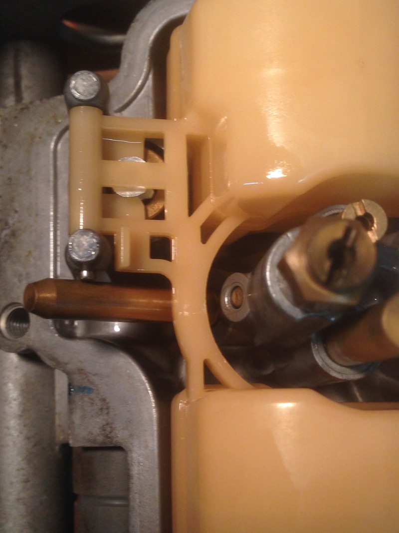

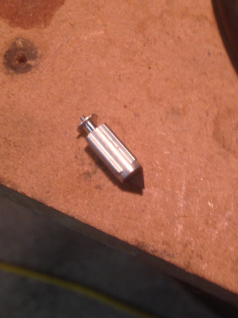

So I pulled the carbs off and looked at the float bowls and needles. Both were clean with no signs of wear and checked the floats for leaks they are good. Checked the petcock on the tank with a vacuum tool and that also seems to be working fine. Really at a loss for what could've caused all this fuel to dump into the cylinders when all looks well

Rebuilt the petcock. Now I only get a slow drop leak in the front cylinder but the rear is good. So I swapped floats and needles from the front to the rear to see if they leak would follow it. Well it didn't it's still leaking in the front carb from the needle so I guess the last thing to do is take a shin out of the front needle to see if that helps. Front is shimmed to 0.0425 and rear is 0.06875

Are you sure the float height is set correctly?
I'm not understanding how a needle shim would affect a fuel flow issue with the bike off.
You should be able to remove the needle and it wouldn't matter. In fact you should be able to remove everything in the carb except the float, float needle, and float needle seat, and it wouldn't make a difference.
The float/float needle/float needle seat are what cuts off fuel from the petcock (unless there is something about these carbs i don't understand, which is entirely possible). When the bike is sitting, engine off, no fuel should flow past the float needle/seat, assuming the floats are set to the correct height.
You could have 20 gallons of fuel directly above the carbs and the float needle/seat would stop it from flowing.

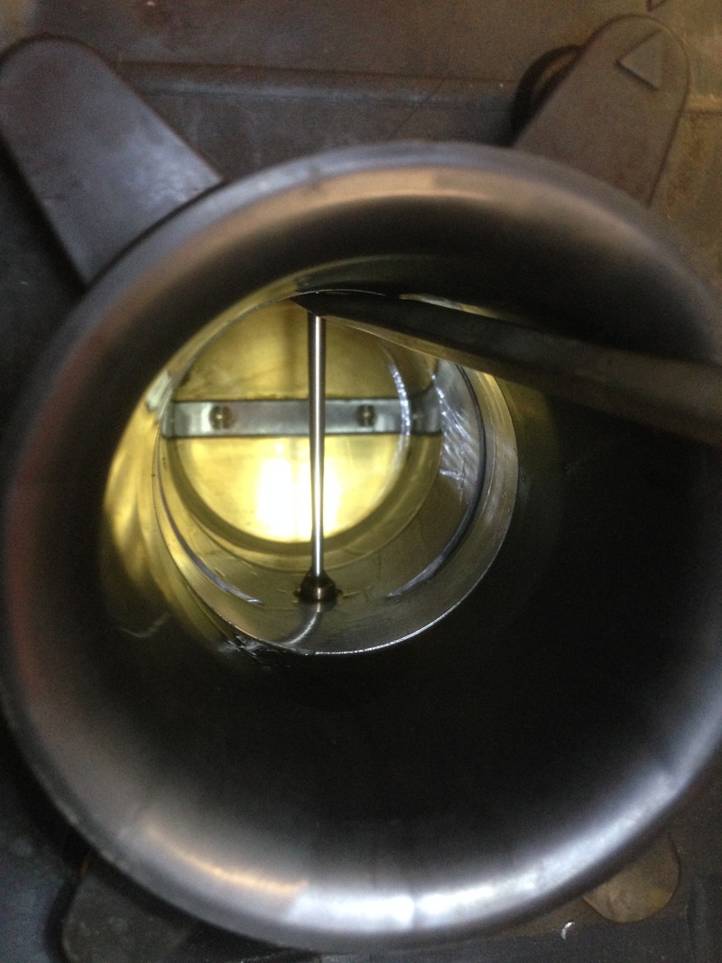

So made some progress on this issue this weekend, here's what's been done:
- Fuel tank petcock rebuilt with new diaphragm
- New choke system installed
- Carbs taken back to stock?
- 175 Front - 178 Rear, needle shims removed, a/f screws 1.5 turns out
- Front and Rear float bowls, needles and float needles swapped to see if problem follows float: Runs lean but no leak
- Carb needles shimmed (0.0425 Front and 0.6875 Rear): Runs a bit lean with no leak
- Carb a/f mixture screws adjusted (2.25 Front and 2.5 Rear): Runs seemingly rich, backfire and front carb now leaking
I'm perplexed that an a/f screw seems to be causing this since that's the only adjustment I made on the front (1.5 ->2.25 turns) before it started leaking again. In my mind this doesn't make any sense... I swapped the needles because the front initially looked like it had a weird wear pattern to it but that nor the floats seems to make any kind of difference. I 'm going to slightly adjust the front a/f screw in this afternoon a bit after work and report back. Video of fuel accumulation below...

Your floats look old, the plastic floats can get saturated and not do their job correctly, not saying this is or might be the problem but I would swap them out because they are cheap and... well... your probably gonna swap out everything anyways
They look old? How can you tell? I did the dunk test in water with them with no bubbles. I tried looking on ronayers a coworker was saying it might be the seat where the float needle sits but I can't find a diagram or part number

just the color, new ones are a very light off white, after sitting for a while my bike started dumping fuel out of the vent tubes, turned out to be dried up old gas siezing the float needles but while I was in there I replaced the floats. And I wasnt saying your floats are leaking but the plastic itself can get saturated with fuel. Again, Im not saying this is the problem, just basic maintenance for an old bike...

Hmm, well perhaps I will order a new set then even though they don't seem to be the culprit. Anyone have a line on the float needle brass seats that are threaded into the carb body? I'm assuming there is an o-ring beneath that but I cant seem to find a part number. I'm going to try and remove them and take a look to see if there is something strange going on.
