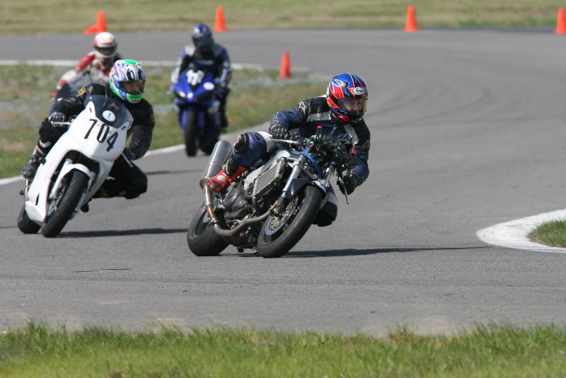

yes, exactly. that is what i meant by the suspension riding in the middle of its stroke, not literally IN THE MIDDLE. And the stock forks are so bad that none of this makes much difference. Attached is a pic of me at Pocono with 954 forks and they are waaaaay at the bottom of the stroke just entering the turn.
