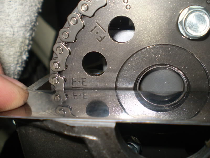

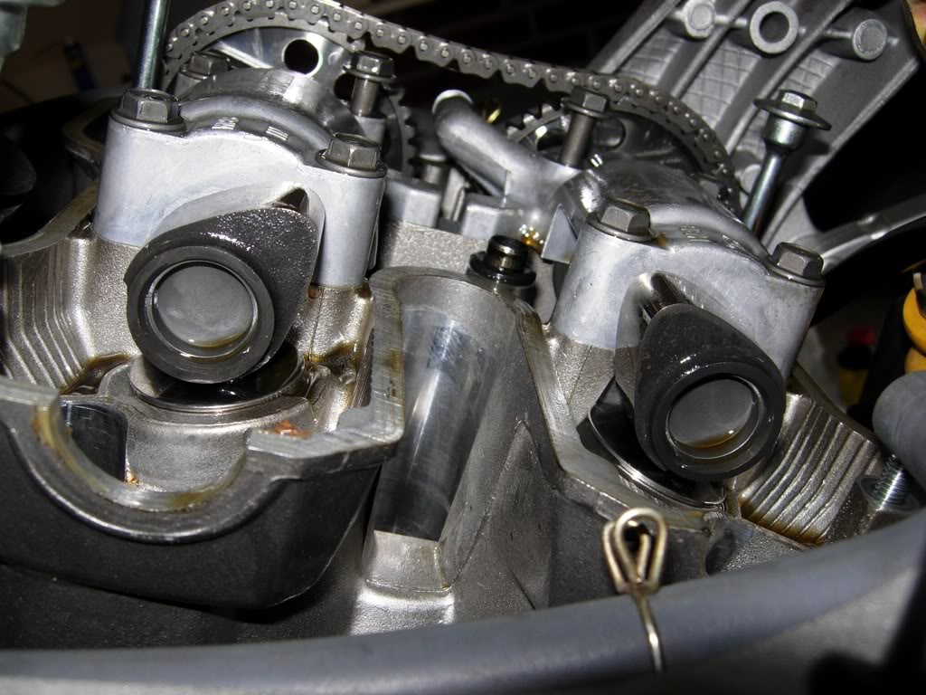

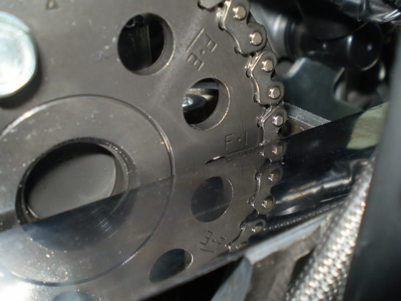

Dead on...
So do I replace the head gasket and inspect the valve seats? Right now I'm looking into the possibility of just taking the top end off and take it to a mechanic to It appears this may be an option (one that is super appealing at the moment)...
Old Mar 21, 2011 | 10:12 AM
What are the actual cams doing at those marks? It is possible to install the cam gears incorrectly.

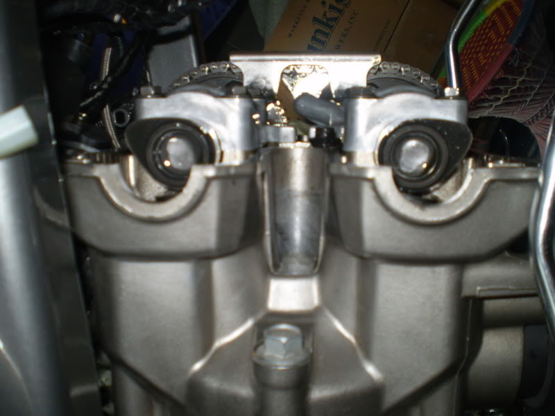

Old Mar 21, 2011 | 10:25 AM
Cam lobes are pointing up and out just like they're supposed to. Flywheel mark is right on the FT... so narrowing it down, heh.
Not that I would know how to tell, but the parting line between the top and the bottom of the motor looks fine (as in I don't visually see any gasket issues), so maybe valve seating issue? The more I look at this, the more I think I can pull it off without much effort. But like you said, I'll do some research on diagnosis before I rip it apart.
Still not fully confident in my tests to determine if it was top end or cylinder ring related- putting oil in the spark just seems weird haha.
Edit:
Maybe they're not pointing up enough. Should maybe try rotating them inwards one notch each?
Looking at the bolt pattern on the sprockets leads me to think that this would be a tough one to mess up though...

Old Mar 21, 2011 | 10:47 AM
I thought the cams are supposed to look like this:
(image stolen from this thread: https://www.superhawkforum.com/forum...install-15184/ )
