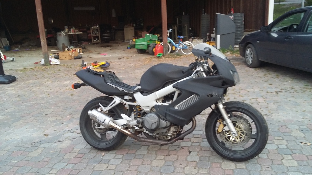

And for those that will ask about what I did concerning the possible streetfighter direction I was thinking. I just zip tied the busted fairings and spray painted it flat black d or now. Name:  20160516_064810_zpse4di5k9p.jpg

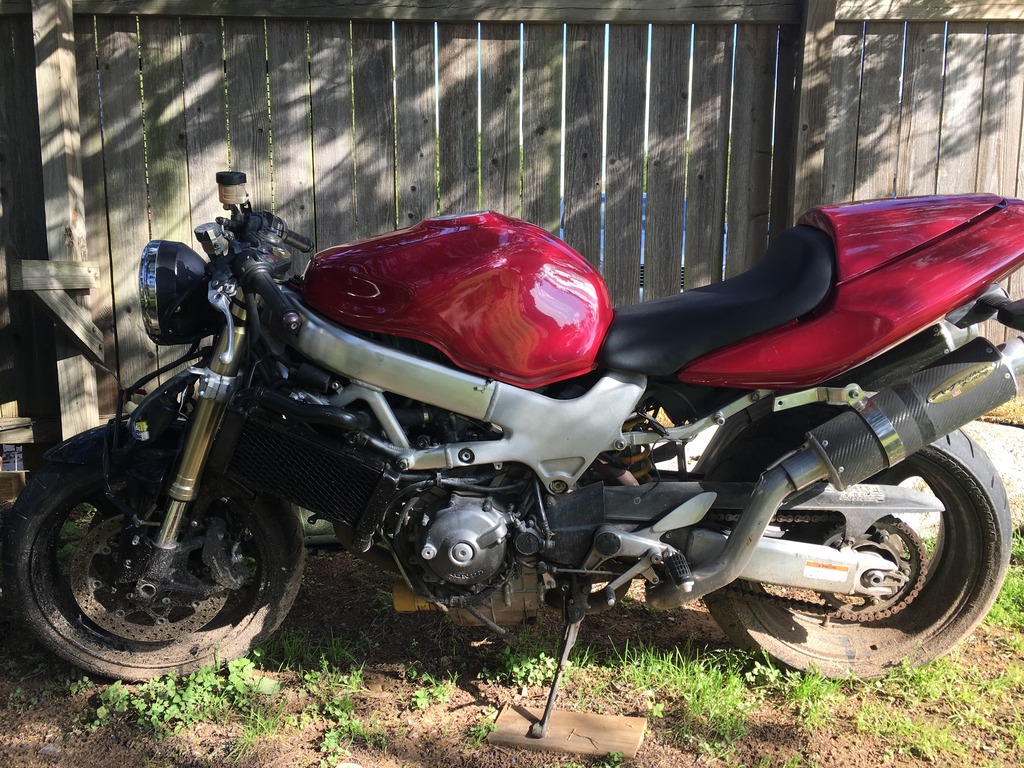

That's what mine looks like with exposed radiators. It's alright, but I personally think it could look better. USD forks, IMO, entirely change the look of the bike.
