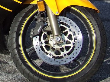

I had a F4 rotor and VTR rotor for a side by side comparison. They are the same diameter with the same offset but the inside diameter is different. The VTR is 59mm the F4 is 62mm. Thus, the bolt holes do not line up.
F4 rotor on top of a VTR rotor;
Now... about those XX rotors.....
That doesn't sound right - the F4 rotors should have been 20mm larger in diameter.
Old Dec 21, 2009 | 08:02 PM
Nope, both rotors are 296mm in diameter.
Old Dec 22, 2009 | 07:52 AM
JamieDaugherty's Avatar
Joined: Aug 2005
Posts: 1,864
From: Fort Wayne, IN
Right.... sorry...
