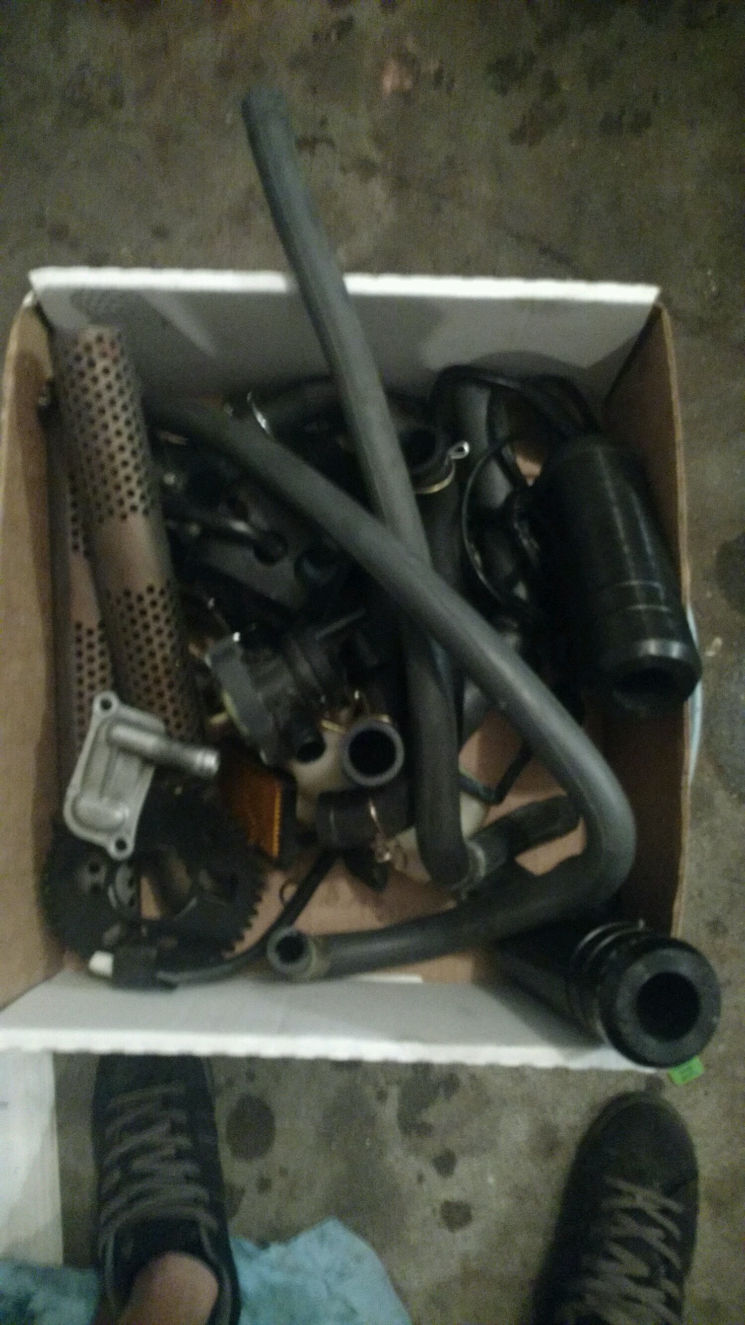

I got my hawk about two weeks ago... I have deleted pair valve added block offs and also got rid of everything else that goes with the smog system. I got rid of the frame sliders rear plate light also put a 4+ advancer on it ditched the anti rattle gear and springs engine ice in it shimmed the carbs to hawk8541s specs thread. filled in some holes that the previous owner had drilled in the air box and fixed a few oil leaks changed oil checked valves and cam timing since I removed the mccts and fixed a few oil leaks I think its good about to take it out in the morning and see how it goes.... hope I am on the right track let me know any input would be appreciated... ohh I also removed the baffles in the delk slipons
seems like she lost about 10 pounds

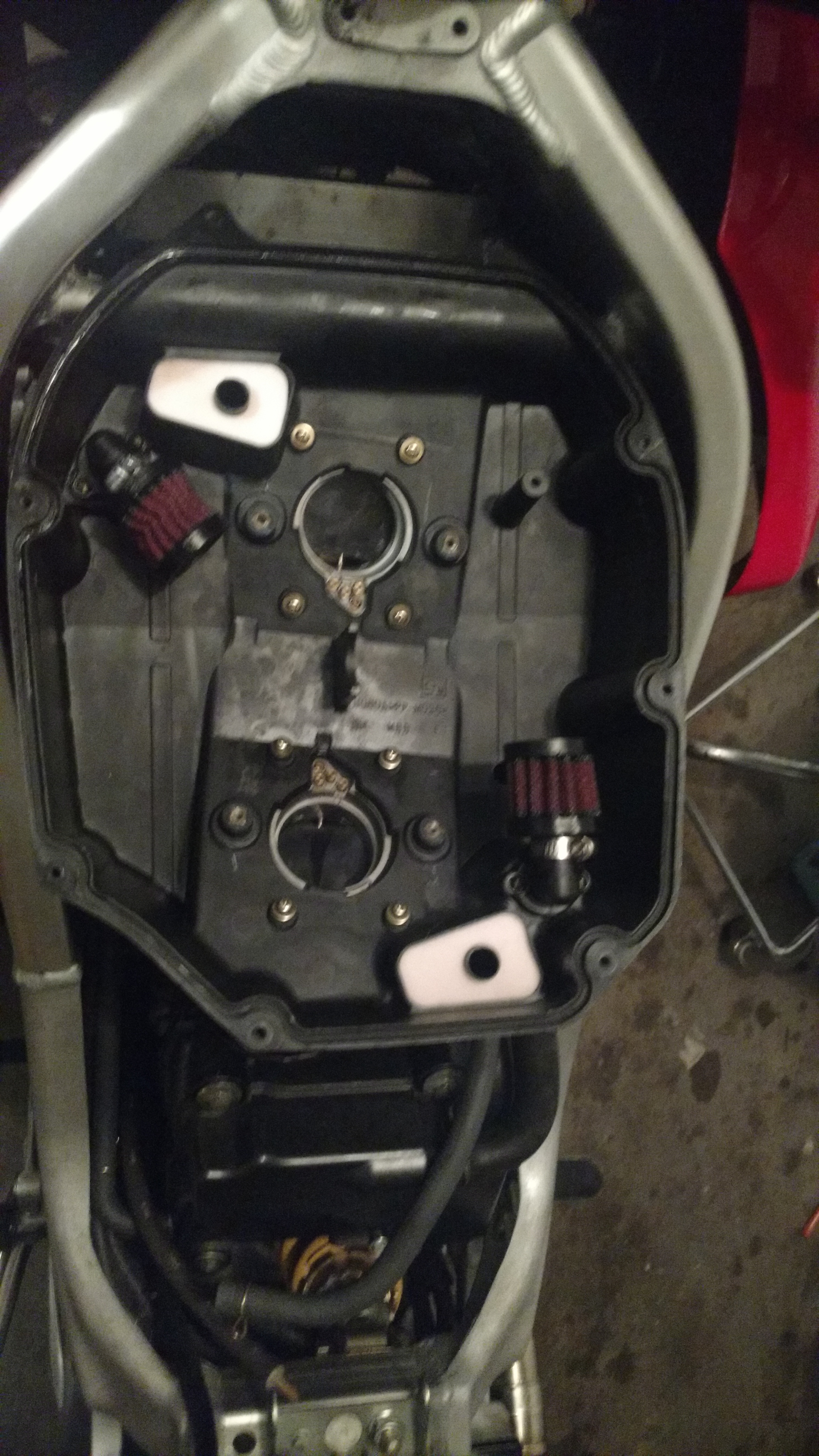

i ordered it directly from factory pro he said it was the very last one. i have a couple issues with my mods. i replaced the rear mcct gasket and it leaks **** so i will remove while my wife holds the crank in position and i think i will be ok with a little honda bond on it. i place a case breather filter directly on to the cover of the valve cover and its dumping oil all over the motor what have you guys done in the past? i cannot connect it to the air box because its blowing by and getting into the fuel system any ideas?

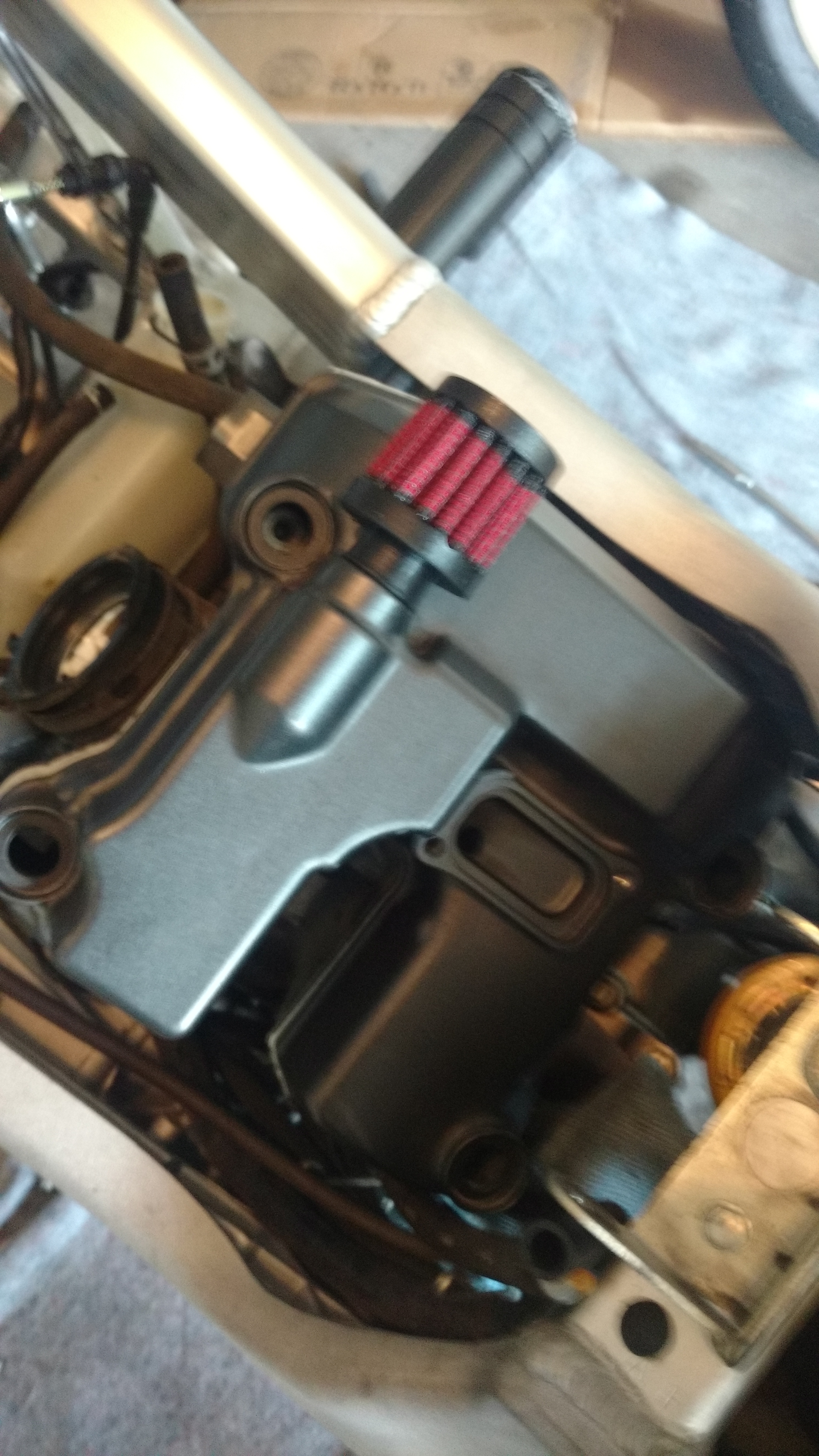

the oil is coming from both case breathers that i installed directly on top of the valve cover i have the oil level under the second notch on the clutch cover so **** so its not coming off the rear tensioner at all. so what do you guys suggest should i put a hose on it then mount and raise them. or should i go with an oil catch can i wouldnt think this problem would be from removing the reed flap or am i wrong about that????

That's how I have them currently
Run em to the airbox as standard.

i was thinking that myself. when i bought the bike it started to smoke after a hard run of about 100miles. i opened up the air box to find that there is a table spoon or so of oiled pooled in the box. left side because of the kickstand but i was trying to avoid this.

Good or bad idea

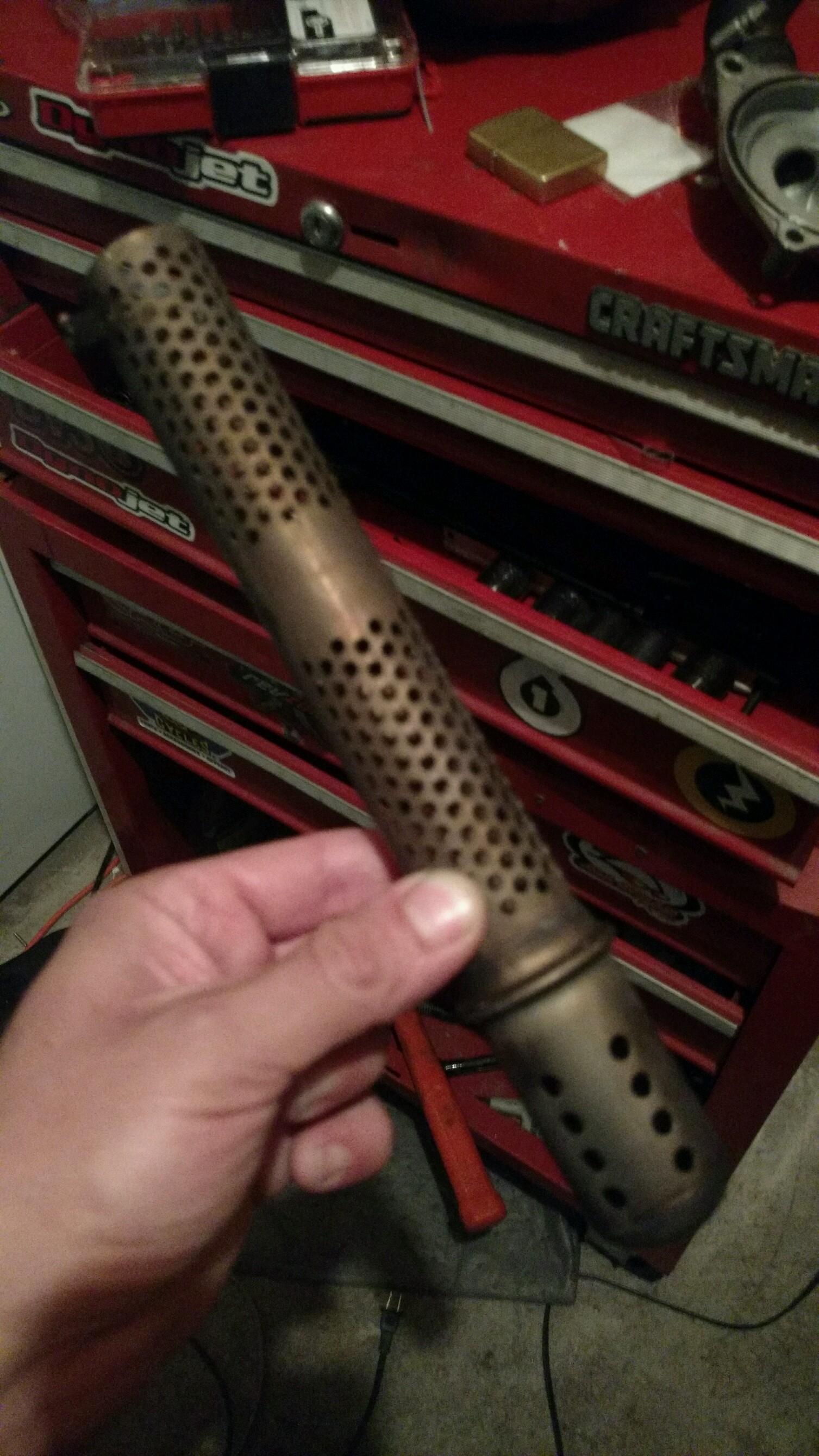

Wait you removed the baffle and all insulation from the pipes? Just looking at pic

baffles
no i did not remove the resonators or packing. i removed the baffles only or db killers whatever term you prefer. loudness has not changed much. the sound signature on the other hand has changed greatly b4 it just sound like a terd. i added a .5 mm shim to the rear needle stock air box and it seems happier im running about 96 octane in it now i know this effects my power curve in a negative way i just do it every once in a while then go back to just pump gas and stiffened up the suspension i am only about 170.

So is bare insulation now exposed to exhaust shock waves? Not familiar with stock stuff but if its exposed it will be gone in a week. If you care.

exhaust
they are delkevic slip on long cans they have a baffle that comes in from the front inlet side kinda different. they have packing with what is called a resonator. a resonator is the perferated steel tube which holds basically all after market packings in that in turn is held in by rivets at each end. so now its just a basic after market can. wish i could send pictures of what i mean but i am at work i will post them when i get home.

this was the only thing i removed
