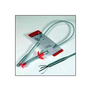

Even with a long magnet tool it can get 'distracted' by other steel parts on the way down to its target!
A claw grab tool is another handy tool to have in reserve
you are quite right, worth double the weight in gold when needed. I may go get one today.
