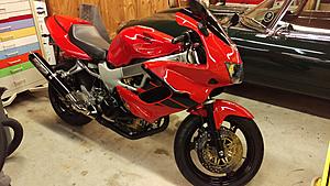

Got to throw this out there. I got my "Bird of Prey" all ready to go for the track. I've been taking it on the street to check its performance. Came across and few issues that need to be cleared up. But the one problem that irritated me the most was the small oil leak on the front cylinder where the cam shaft and cam chain is located on the thin wall between the cylinder head and the cylinder.
The cylinder head gasket was leaking very slightly. So I put out a distress call to Roger Ditchfield -- the guru of VTRs. Very happy to have him reply and he said there has been a problem with the cylinder head gaskets in this area. It has happened to him twice now and he said that the cylinder head gaskets have been too long on the shelf.
This is his response to my email.
(ME) Just one more thing, I bolted the cylinder head gasket down to all the specifications, but the front cylinder leaks oil from the cam shaft chain side for some reason
(Roger) This is becoming an increasingly common issue. It has happened to me on two occasions. I believe that the head gaskets themselves are the issue as they are pretty old stock now coming out of Japan. Before re-fitting a new head gasket check with a straight edge that the head is nor warped.
Anyway I am not going to do the Head Gasket yet, I will put up with the leak, just in case there are any more adjustments that need to be done. Once I have it running correctly....I'll have to rip open the front cylinder again.
