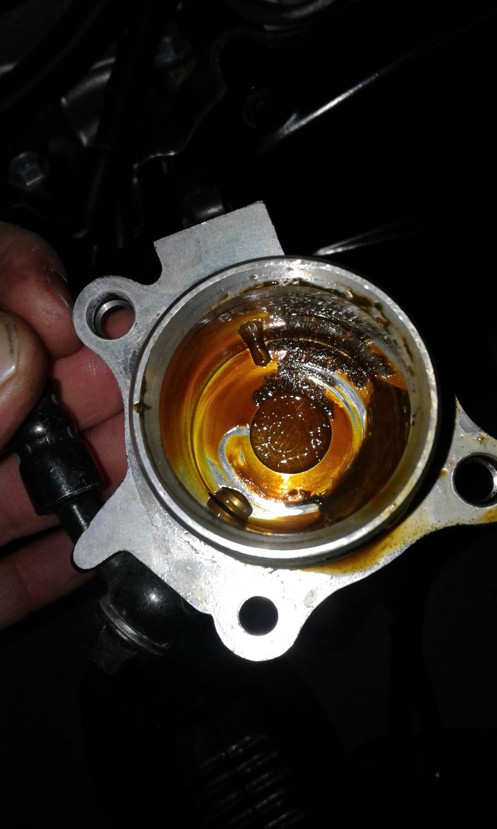

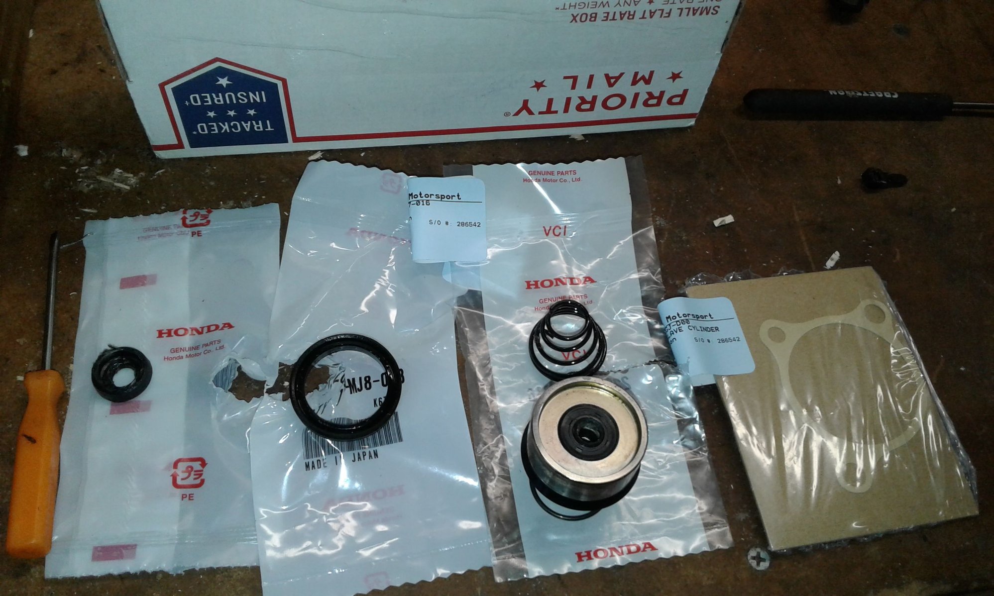

Do yourself a favor and buy a clutch master rebuild kit and buy the parts to do the slave. I can almost guarantee they both need it if not done recently. Here pic of what mine looked like, and I'm a stickler for routine maint.
Parts needed for a slave refresh
Nasty!

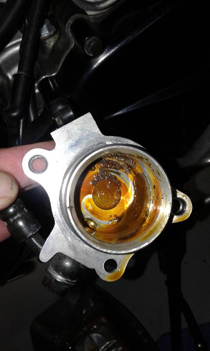

I'm guessing the fresh seals in the master will alleviate your heavy pull. It shouldn't be a difficult as you describe. Here's a pic from a CBR1k I did at work.
This wasn't mine but if you suction the fluid out and remove your cup and see this, you know the entire system needs rehab.

I hoped I'd do with only a quick toothbrush scrub with IP alcohol, but at least I didn't find out I needed to get the parts AFTER taking it all apart.
What it that stuff inside the slave? Rust or only sludge? And if rust, can it be just buffed off?
The slave was tampered with as there is a trace of liquid gasket (as they likely reused the OEM one), but that is before the last owner got the bike (1st owner '03-14, 2nd '14-18, now me).

All that is a sludge mess, no rust. It all cleans up with due diligence. Be meticulous,

Here's some part numbers.
https://www.superhawkforum.com/forum...roubles-31861/
GSKT, SLAVE CYLINDER
Mfg. Part Number: 22862-MW7-650
Price: $3.91
CUP, SLAVE CYLINDER
Mfg. Part Number: 22865-MJ8-003
Price: $7.70
SPRING
Mfg. Part Number: 22864-MT7-016
Price: $4.31
OIL SEAL (8X18X5)
Mfg. Part Number: 91209-MB0-003
Price: $2.81
From Ronayers.com
