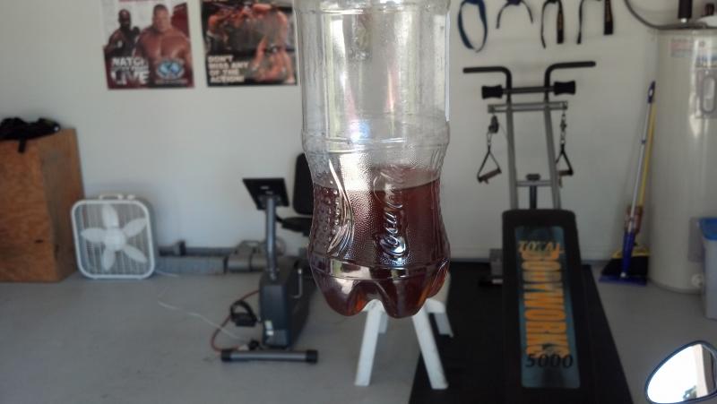

Just did mine, Clutch, F/R breaks. Levers and pedal feel much better.
Here is what came out....YUCK!!!

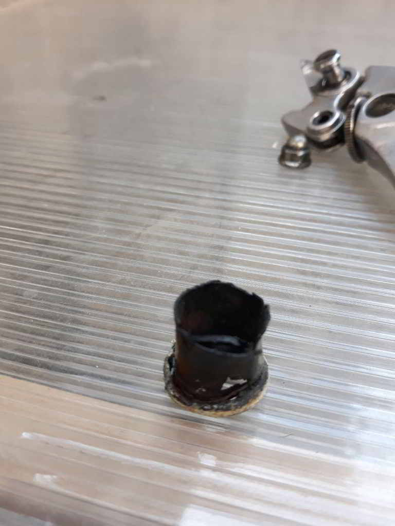

Finally found the culprit- check out this MC boot... thank God I found it, I really dodged a bullet with this one.
ps: the internal gaskets were also bad- not perfectly round and the reservoir fluid port partly obstructed with little flakes of rubber. Apart from dirt, there was also a lot of calcification, likely from water that got in through the broken boot. Probably, in a life or death situation, after proper cleaning, some compressed air through the reservoir port, and a lot of rubber grease, it might have been able to be pump a bit of pressure... for a little while.
Arranged to meet a guy tomorrow for a set of f4i MC + f4i calipers- he swears they're in excellent shape but I've also ordered rebuild kits for both front and rear MCs which I'll be picking up on the way, just in case. I'll fit the MC tomorrow and install the calipers at a later time, after grinding them down to fit and getting new seals and pads. The rear MC is surely in a similar condition, I'll rebuild it's MC and fit steel braided lines by next month. And then the clutch...

Is that the boot that keeps debris out of the master @ the lever?

Yes, it is.

Culprit to what? Its just a dust boot

Culprit as in "this MC is broken", as I described in my message
