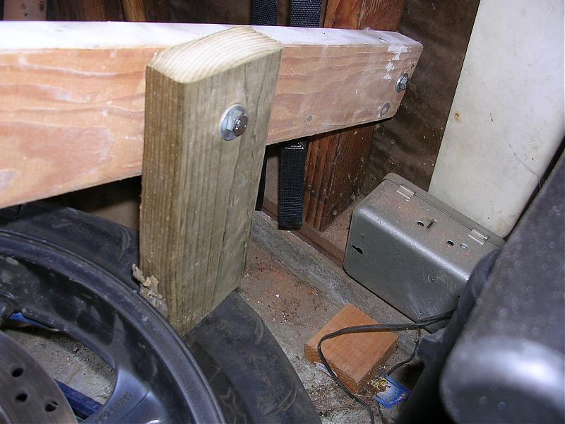

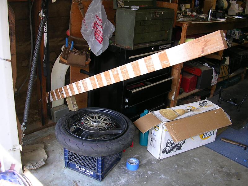

Tire removal
I have a home made bead removing tool bolted to my garage. It consists of a 5 ft long 2 x 4 bolted with a single bolt through a stud in my garage, with a 10 in. 2 x 4 bolted to it about 1/4 of the length away from the wall. It works great for unseating the beads. My intention was to be able to dismount and mount tires myself, but I don't have "spoons" or levers of any kind. At this point I am not too worried about my wheels, but since the above mentioned device is all wood, it doesn't scratch the wheels.
I use a square milk crate as a wheel stand, however using a 15" auto wheel with rubber around the rim would probably work better.
