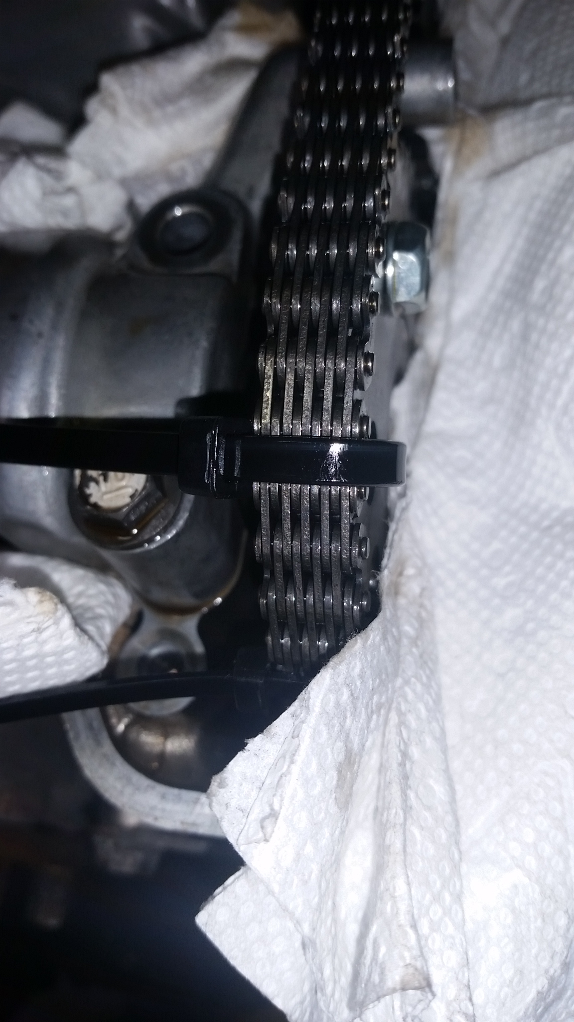

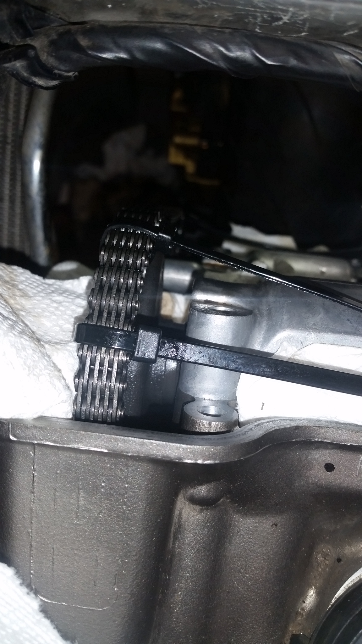

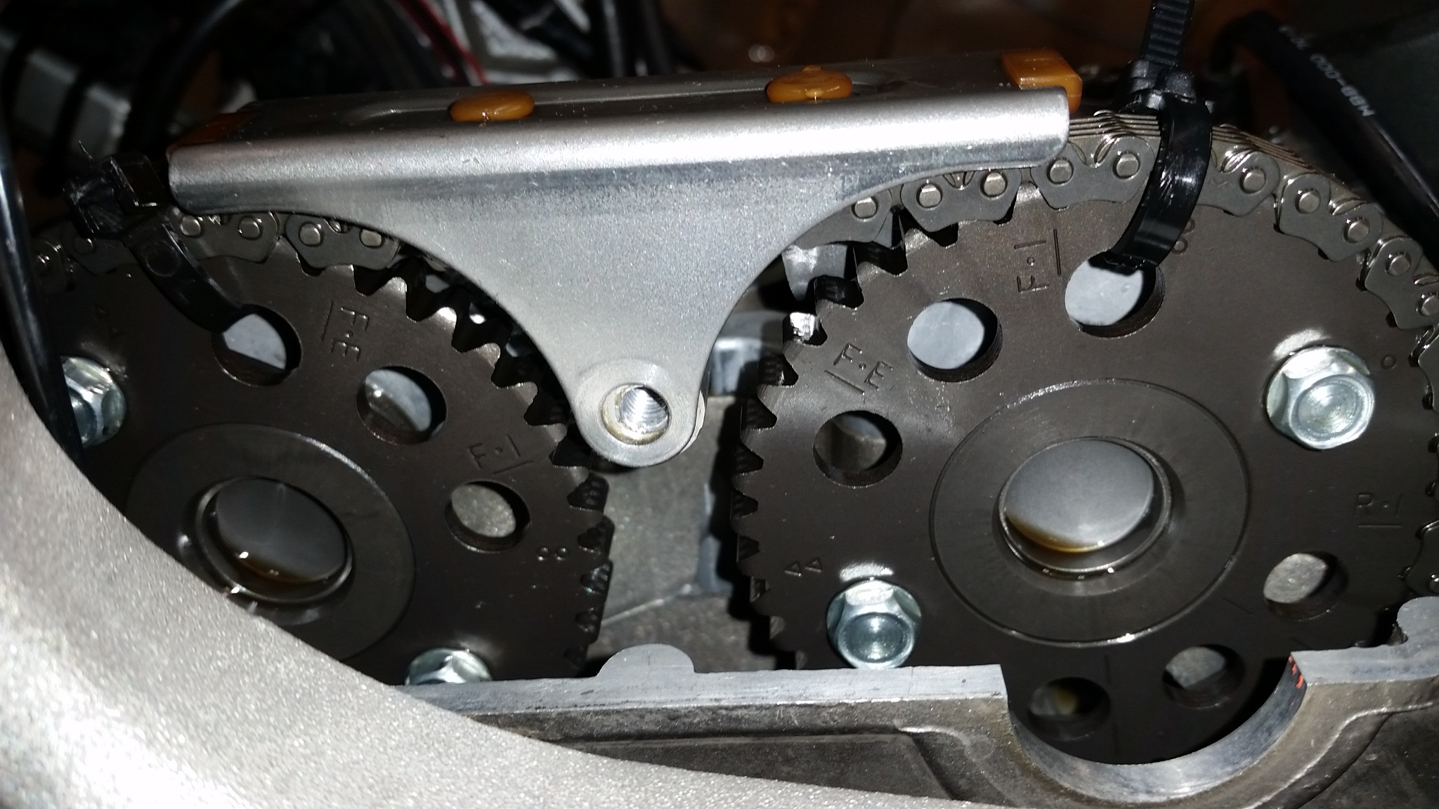

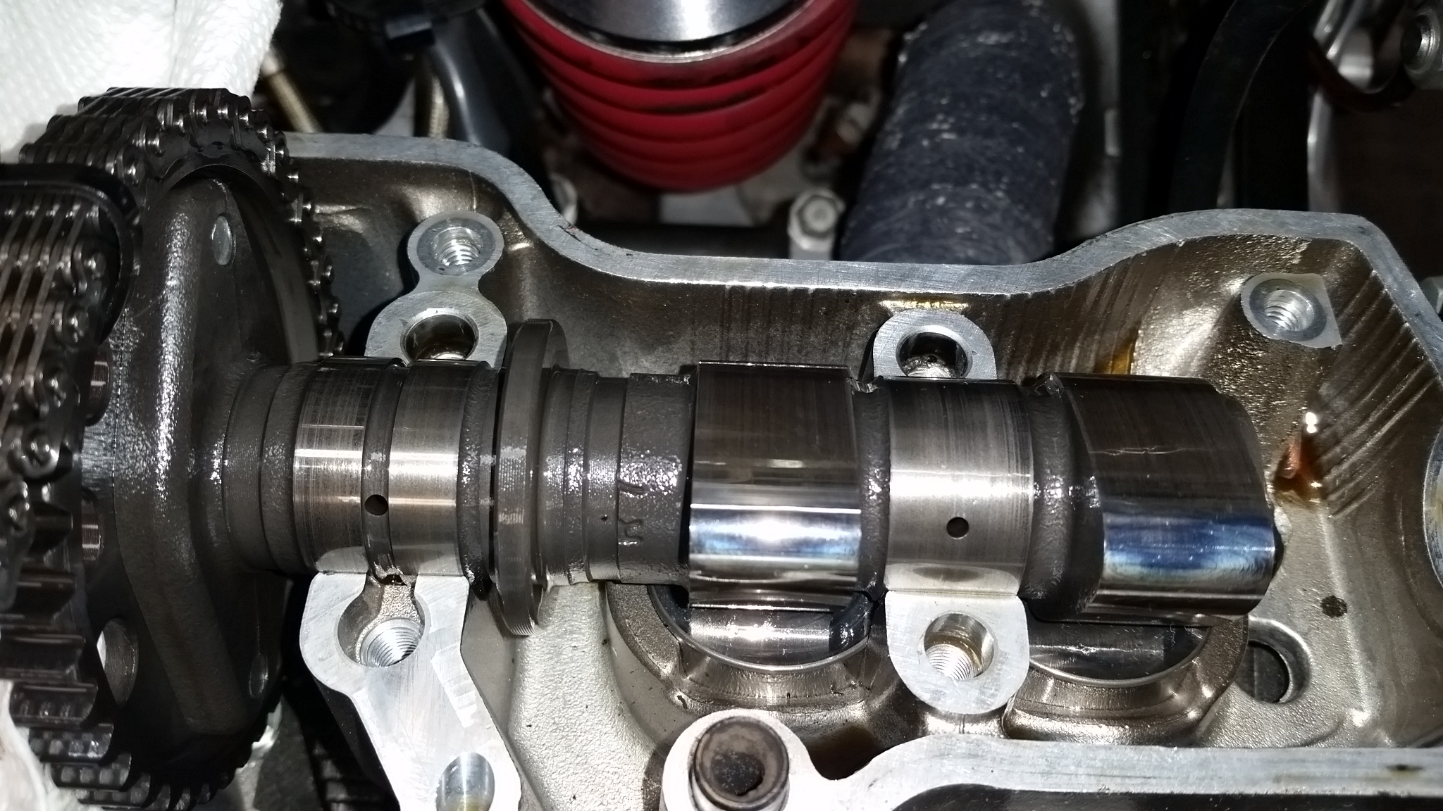

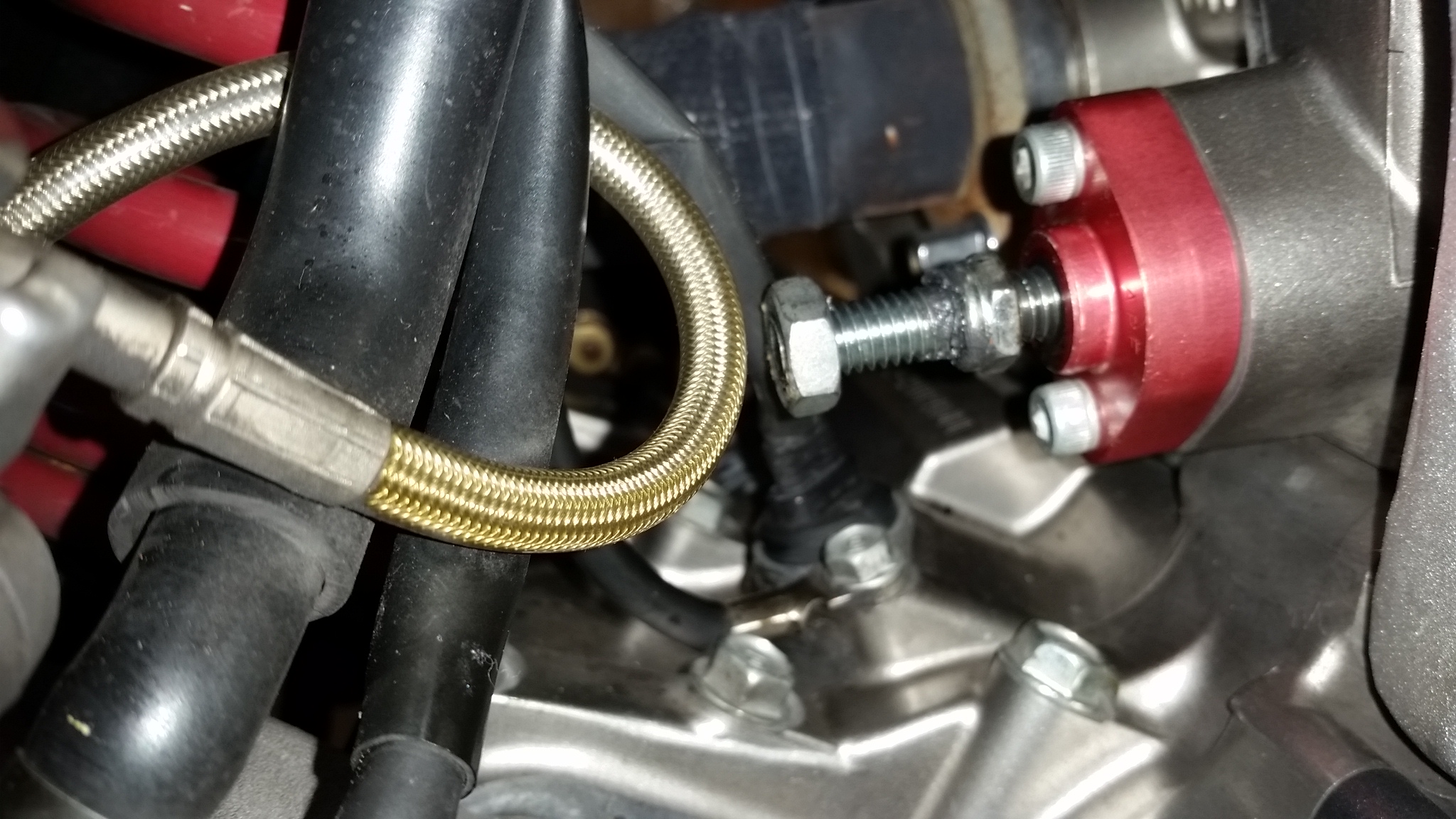

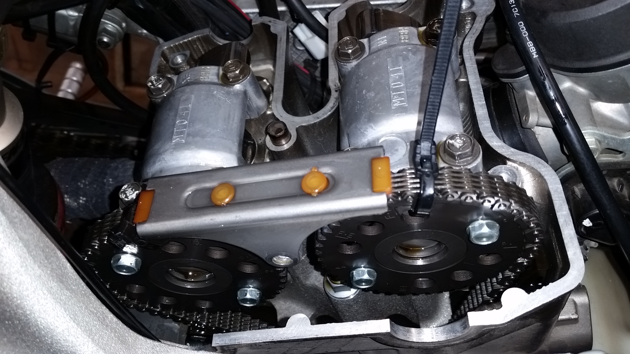

I was given basically new oem cct and I passed and long ago went with the APE manual cct. When I check the valve lash I check cc tension but if it seems a bit noisy I run it until hot and then back off the cct lock nut, very slightly back out the tensioner bolt until it rattles distinctly, the turn in the bolt until it juuust stops rattling, snug down the lock nut and it's good to go. I replaced the oem cct with the APEs probably at around 20,000 miles, so, knock on plastic, that was about 90,000 miles with no related issues...
Below are photos of my work removing someone else's OEM CCT, a finished PAIRectomy, and me checking and adjusting my own rear cylinder's valve lash (9 out of 10 times the exhaust valves snug up). However, in 110,000 miles, I've only had to swap out maybe a total of 6 or 7 shims...
Attached Thumbnails CCT question-20160227_141906.jpg   CCT question-20160227_141925.jpg   CCT question-20160227_134710.jpg   CCT question-20160227_180001.jpg   CCT question-20160430_132600.jpg
CCT question-20160430_132548.jpg   CCT question-20160430_120514.jpg   CCT question-20160430_132614.jpg
