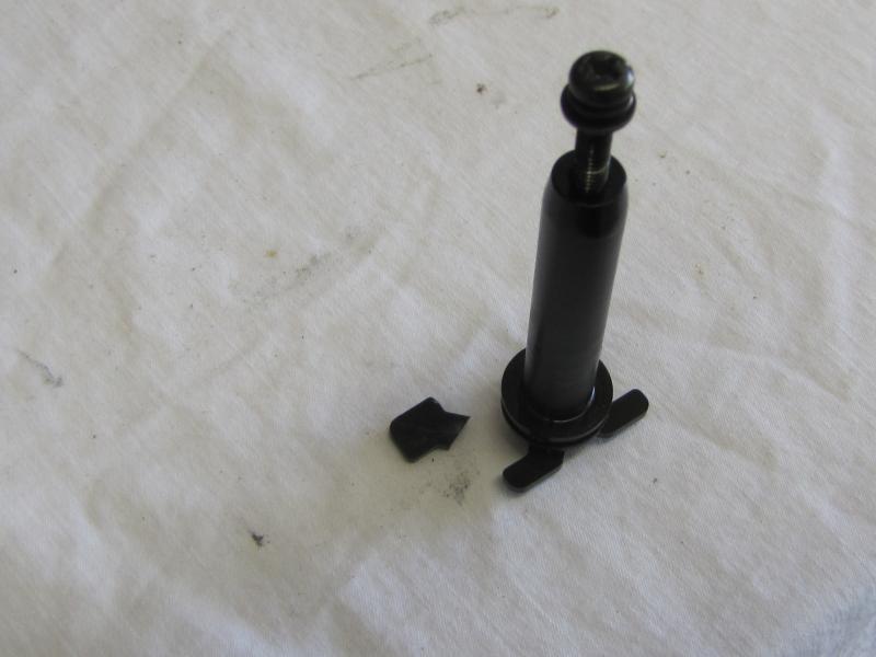

Beginning to think your right about K&N Marquez... Attached is a photo of my latest screw up. K&N says to drill an auxiliary slide lift hole in the slide with the needle retainer installed. as you can see from the photo, it didn't drill, It broke. In looking at the assembly and K&N's directions, I don't think this broken tang on the retainer will affect anything. Would appreciate any feedback (outside of I don't know WTF i'm doing)

Old Apr 30, 2013 | 01:21 PM
Originally Posted by wndsrfr48
Beginning tothink your right about K&N Marquez... Attached is a photo of my latestscrew up. K&N says to drill an auxiliary slide lift hole in the slide withthe needle retainer installed. as you can see from the photo, it didn't drill,It broke. In looking at the assembly and K&N's directions, I don't thinkthis broken tang on the retainer will affect anything. Would appreciate anyfeedback (outside of I don't know WTF i'm doing)
Mfg. Part Number: 16037-MBB-640
$11.91 http://www.ronayers.com/ProductDetails/N/687/SKU/240853
Replace it, and know it is not partof a tuning issue later.
Mine drilled just fine years ago,,,,but when working on the carbs this last time, that same little ear brokeoff.
It might be fine, it might be fine for a week, month... it might allow that retainer to come loose.. flutter, cause my muffler bearings to fail.. I don’t know for sure that it will cause any harm,,I do know for $11, I just ordered one this morning, and won’t have to worry about it.
I'll stick with 8541Hawk's suggestion of not drilling open the additional slide hole. I already closed mine from the DJ setup. P.S. PO didn't drill a hole through the broken part pictured; only the slide housing itself. (Which I already epoxied closed.) 1 hole front 2 hole back currently.
Food for thought.

I'm pretty sure that it's the o-ring that holds that part in place. Notice how it "snaps" into place?

Old Apr 30, 2013 | 02:05 PM
I'm prettysure that it's the o-ring that holds that part in place. Notice how it"snaps" into place?
I am too, but I’m also aware, theOEM does not add the rest of the part to the design, just for looks.... itcould be an assembly line aid. It might be so the part does not roll off thetable at the factory… It could be more,, what it is for sure is an unknown.
SO for $11... it is a variable to thetuning plan you do not have to worry about or consider.

Originally Posted by WhOrD
I'll stick with8541Hawk's suggestion of not drilling open the additional slide hole. I alreadyclosed mine from the DJ setup. P.S. PO didn't drill a hole through the brokenpart pictured; only the slide housing itself. (Which I already epoxied closed.)1 hole front 2 hole back currently.
Food for thought.
I agree, forget the extra hole.. andthe K&N airfilter, K&N needles, springs, propriety numbered jets as well,
Then replace that broken part with anew one... and follow the 8541Hawk tuning plan..... it works.

Obvoiusly I need to do more research, go over 8541 hawks plan, and map out a strategy. And Marquez, part of that strategy is to buy a new part. Much, much thanks for the part number and unputs. That being said, I must qualify my statement about K&N. In the past several years, I have installed K&N jet kits on a number of bikes, mine and others, and always had satisfactory results. Easy start, no stumbles, good power. Again, to all yuos guys, Marquez, Hawkrider WhOrD, many thanks. I'll be around, and I'll update. I trade bikes every 6 months, but the SuperHawk has me in its spell. I think I'll keep this one.
