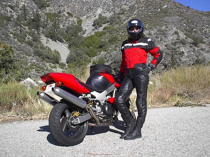

I have been looking at Jetting threads, Mike. The bike is stock except for some custom/ loud/ free flowing muffler cans. These were made by a guy who builds for Muzzy and a few other brands, but they are "one off". Should I Re-Jet the carbs or put the stock cans back on? She normally "carburetes" well, if not just a little abrupt at low speeds off to on throttle transition.

Pipes
Lets see if I can post a photo of Kimi and her 'Hawk, so you can see the pipes:

agree with TXsuperchicken about mechanically cleaning them - easy to damage and if you do get a wire through there is still a bunch of crud stuck to the walls. If you have a stock airfilter and only slip-ons, personally I think stock jetting is fine. You get some backfire on decels but that sounds cool. If you wanted to tinker you could shim the needles a tiny bit and get a little better midrange response, but these bikes are pretty good as is.
