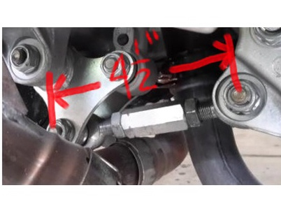

Really no point in doing all that work and spending money on things you don't need. Give me a few minutes and I will get you the length of the stock part. Then, just adjust yours to the stock length.
I'll edit this post in a bit...
EDIT: The length of the stock link is exactly 4 1/2" from center of bolt to center of bolt.
Yeah I guess that will work. Thanks!
