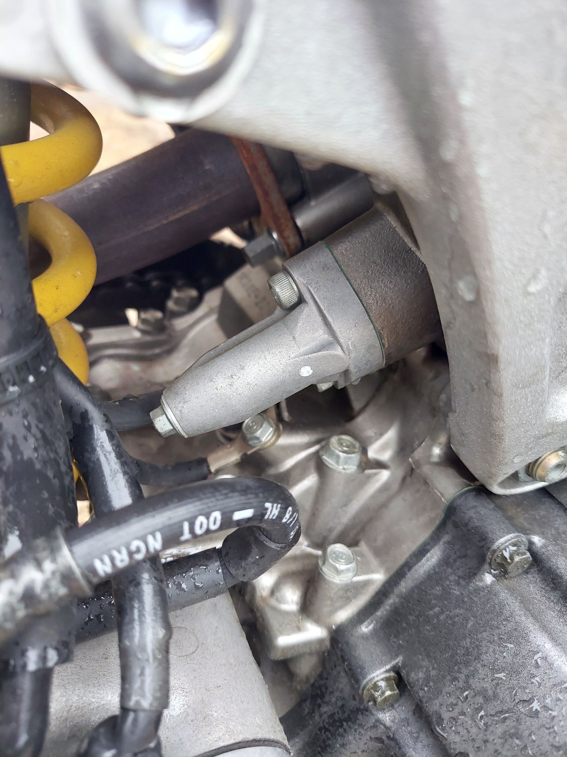

Newbie here, first post. I have been interested in these V-Twin bikes for a little bit and looking for a fun summer project to wrench on. This bike isn't perfect cosmetically and has a tapping or clicking sound when it runs. Could this be a loose timing chain, possibly valve train, or worse? The bike has its OEM chain tensioners, I believe (pic attached). I would greatly appreciate any thoughts. I've rebuilt a 350 SBC a couple years ago and a Suzuki Katana 1000 engine over 10 years ago, so familiar with engine internals. However, my first time with a Honda.

That does not sound like a normal noisy SuperHawk motor to me. That tapping doesn't sound right. Is it hitting on both cylinders? Kinda sounds like it might only be firing on one. If so, it could be missing due to bent valves resulting from jumped timing after an auto tensioner spring breaking. Are both headers heating up?

I would say worst case is a hole in the piston crown from hitting a valve, but that's unlikely. I'm not sure I ever remember anyone experiencing that on here. If there are bent valves as I described, it's more likely the front head. The front and rear are not directly interchangeable FYI. Yes, that means swapping a head or replacing valves if that's in your skillset.
The bike will run on one cylinder and can be ridden that way, though it's a bit down on power. Don't ask how I know.
Oh, and yes, that's an OEM tensioner above.

Got it. I wonder if that clicking sound is the chain skipping over the cam gears, if the chain tensioner totally failed? He said it was making a small tapping sound, then got worse when he had to drive it home.
