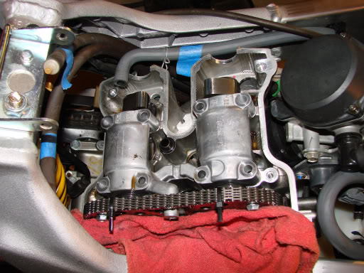

That is great, not more CCT worries, put hight temp silicone sealer on the bolt threads (all 3 per CCT) upon install. See photo of where the cam lobs should be for CCT install.

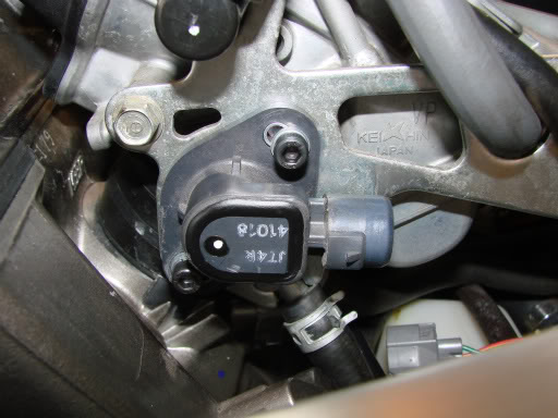

Whie you are in there, check your valve clearances, and by all means - adjust the TPS. That TPS adjustment made a huge difference for me. Results vary bike to bike, mine were great, good KB articles on this. Went from being a beast to start to one quick push of the button.
