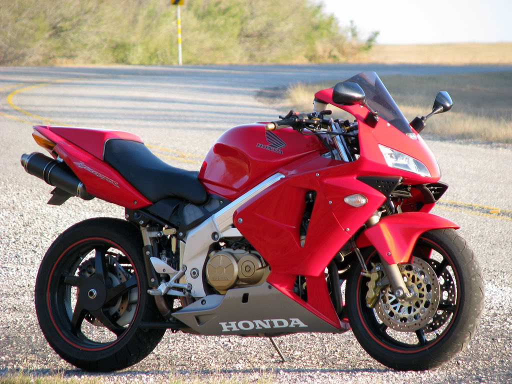

If you don't have one, get a longer banjo bolt for a two line connection. Then only run the longer line from the master cylinder to new longer bolt at right caliper with the shorter line from there to the left caliper looping over the fender. Make sense?
I use this setup on my RCBVFR. Can you see what I'm talking about?

Just to clarify, those lines in the pic are gixxer lines. I got the whole set (calipers, m/c, and ss lines) for $80 on ebay (yeah baby!).
Maybe the vendor got confused and sent you gixxer lines instead of superhawk(?).
