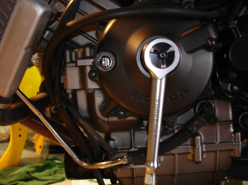

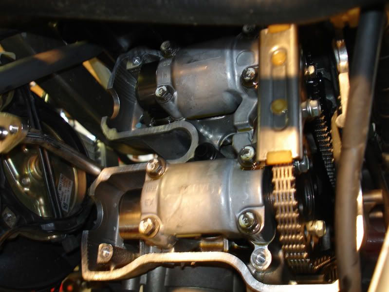

I'm startin this thread to help out everyone who is about to do their CCT's. I can confirm (with pics) that after removing the rear valve cover to check cam position, hand cranking 450 degrees counterclockwise (1 1/4 turn) will allow you to change the front without removing the cover (which is a total pita).

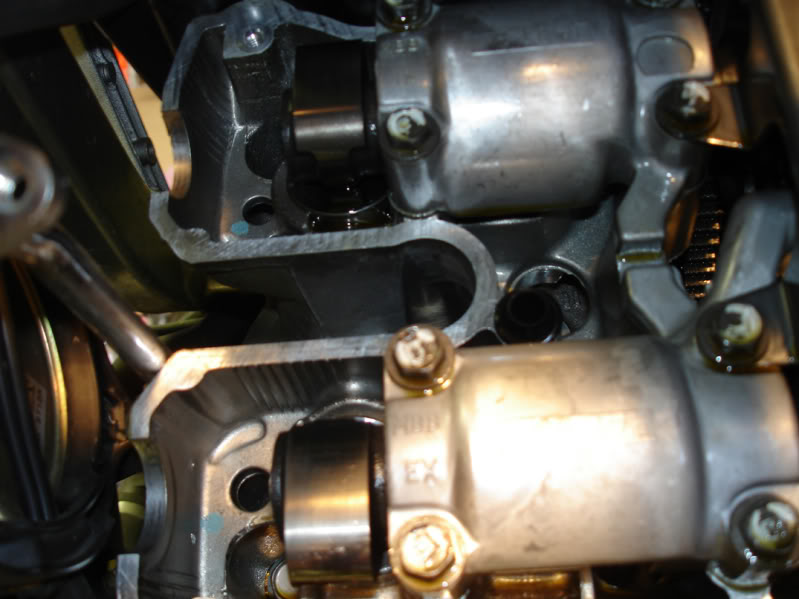

As you can see, both lobes are off the valves.

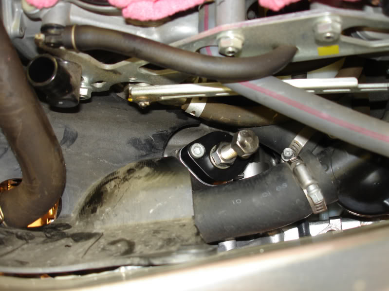

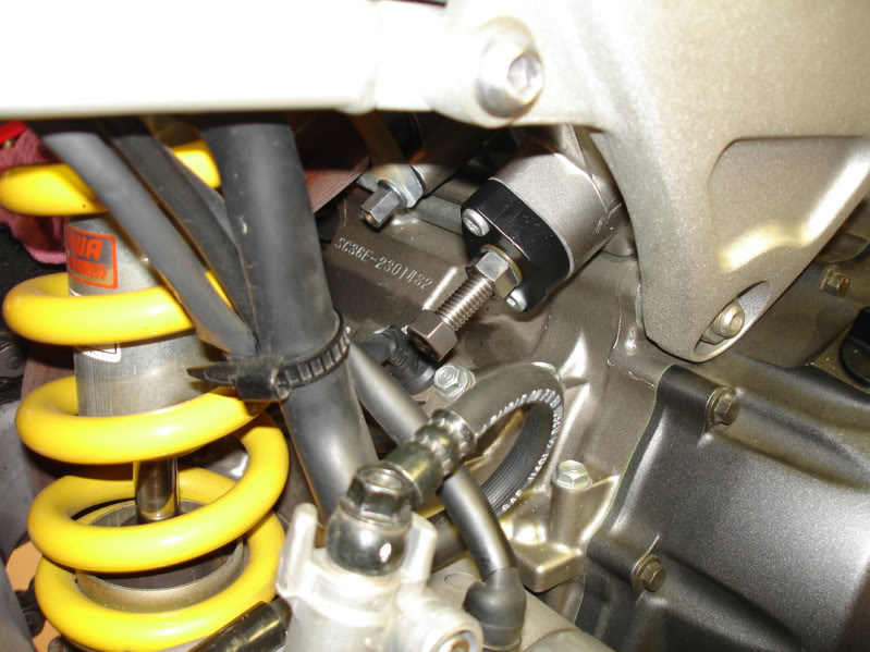

I just finished installing Truckinduc's tensioners. Everthing was pretty straight forward. I searched and couldn't find any posts where someone confirmed the 450, only quoting the manual. So for piece of mind, I went ahead and removed the front cover to make sure. Hope I can help someones job go a little faster than mine.
Here's a couple more shots:

Great pics, me and lazn did both ours at the same time about 6 months ago. 450 worked great. We have not had a chance to put the pics up yet. I think we took almost 50 pics of the steps required. That looks to be a custom by Truckinduc.
Old Apr 11, 2009 | 04:34 PM
Truckinduc's Avatar
Posts: 1,033
looks good man. I just put a set on yesterday.

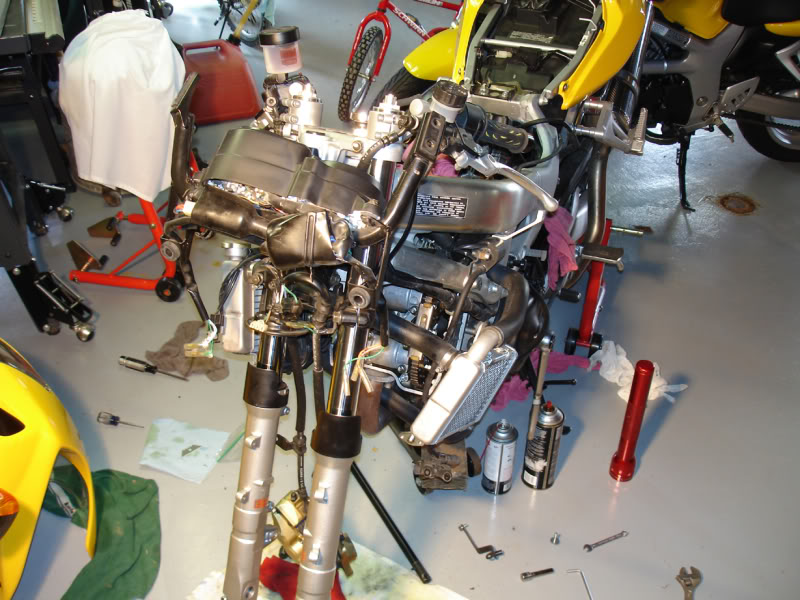

I got Trucker bling!
Here's a shot of a very messy work space:
I wish I would have had pair block-offs to get rid of all that plumbing. What a mess!
