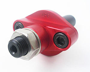

Actual use would indicate your concerns are not popping up as you theorize they might.
There is no need to tension the chain, the CCT is there to remove the excess slop, The MCCT once installed correctly is doing just that... In theory, it might need adjustment again as the chain, sprockets and chain guides wear, in reality Ive not had to readjust in 36,000 miles on one SH, and 22,000 miles on my other... Nor the dozen of SH and tens of dozens of other models I've installed manual CCTs on.
Where to get um? Well you can have um very cheaply on ebay, and hope they work out, you can get them moderately priced from Kreiger, APE, Bazza and Ade Whitmarsh's CCT's - VTR1000.ORG and know your getting a great product..I have these on one of my SH now. Or you can get them from APE and have the same thing as Kreiger's known quality...but at a bit more price for the design and trickery APE has put in them....are the APR's better for the money? Probably not in this application, but they are a nice bit of kit.. https://www.superhawkforum.com/forum...1&d=1517407117
Attached Thumbnails 34k on my VTR how urgent is the  manual CCT-ht900-pro.jpg
