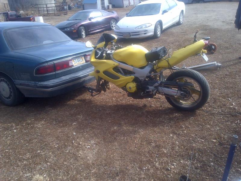

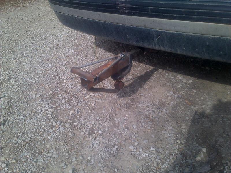

So I'm headed across the state to pick up my bike from my moms and about half way she calls and says that the weather is going bad and its going to be about 30* for the next several days... So I had to either ride it home 5 hours or come up with something else so here's what I came up with
I'm headed back in the morning so hopefully I don't get pulled over or anything
Fingers crossed

WOW, I must say this is quite creative. How did it tow? I am impressed.
Also welcome to this fine webpage, you will find more than you probably care to know about the SuperChicken here. I know I have.

Ill find out tomorrow but its way over built so it should go well. The car already had a hitch and all the material was laying around the farm so no money out of pocket either

Yeah, very creative way to get it done! Only thing I would check on, is some states require a flag attached to anything extending four feet or more past the rear of the vehicle. But, not sure if that applies to a motorcycle being towed?
If it was me, I would just wing it, but if you were worried about the cops, swing through your local Homeboy Depot and grab a free flag...or use a red bandana if you have one, pretty much anything red really.

Might need to remove the chain so that the transmission shaft is not turning when the oil pump is not operating?

Well I'm about 2 hours away from home and its been working great so far I wish I had thought of this last year
I thought about taking the chain off but didn't get around to it...

This type of hauling isn't exactly new and certainly not harmful or dangerous as far as I know... They sell kits to haul bikes in a similar fashion with the front wheel still attached. Granted, not as cool as a home build version...
So I would assume they're pretty legal and relatively harmless to the motorcycle.

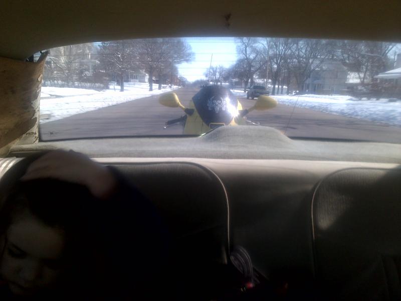

Almost there bike still secure and my daughter playing fruit ninla

See, that would have been my view all the way home, oblivious to what is happening in front of me, only looking at the bike and listening to Fruit Ninja!

Looks to me like his tow framis replaces the front wheel with the axle holding the bike in place. No way it could fall off unless the axle were to fall out and that's not likely. If you put tie downs on it, that wouldn't allow the bike to lean when the car turns causing mucho tweakage.
