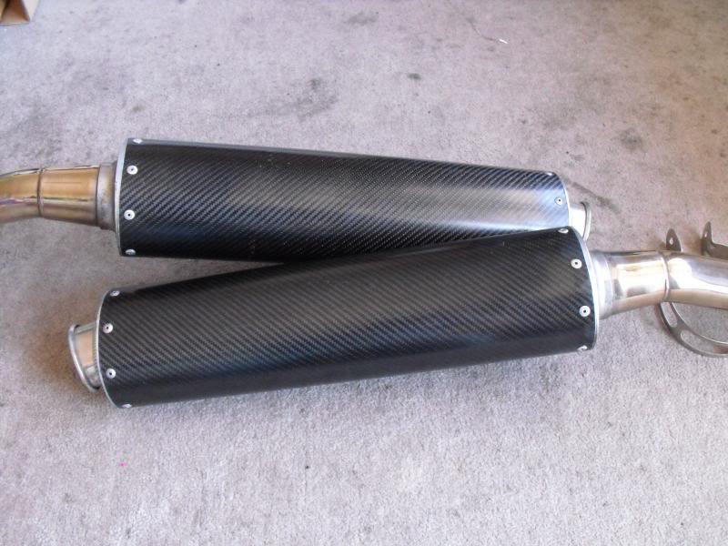

I thought I would take some pic's of my experience doing a muffler re-pack & re-skin, also put some parts on the scale as I went. When I bought my VTR it came with crash damaged Stainless Yoshimura RS3's. So I bought some carbon sleave replacements to repair them. This is not a how to, just the way I did it, The two things I have done differently are, I used aluminium rivets instead of stainless rivets because I already had the aluminium rivets and I did not re-use the metal bands as mine were damaged. This is a budget build, if you want to do it as Yoshimura have, then use Stainless rivets and re-use the Yoshimura bands.

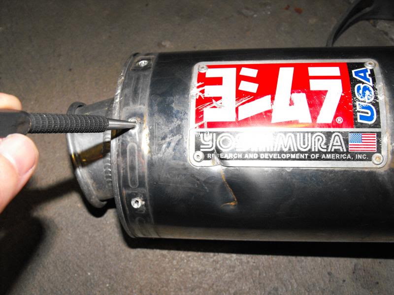

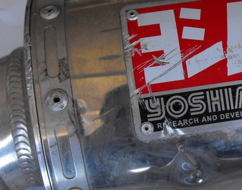

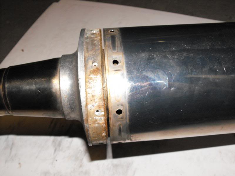

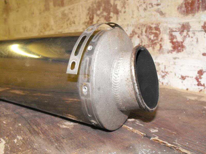

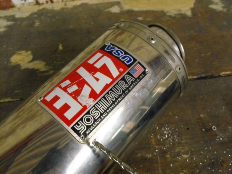

First step was to drill out the rivets.

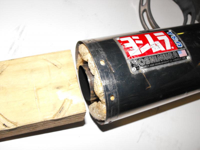

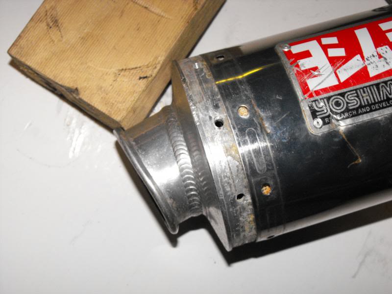

Then use a punch to drive out the rest of the rivets.

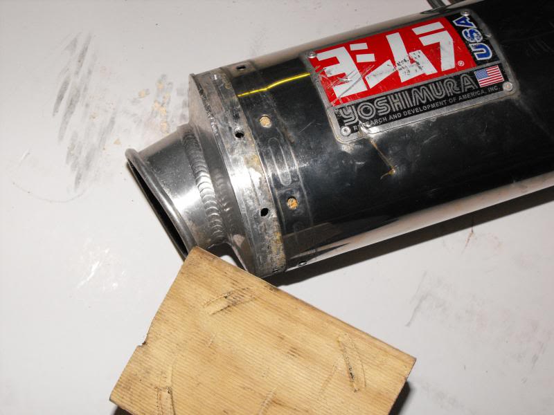

Now the next step Yoshimura say to use a rubber mallet to tap off the end cap, I tried this and had no luck, so I found a piece of soft pine timber and tapped out the end cap. Worked fairly easy.

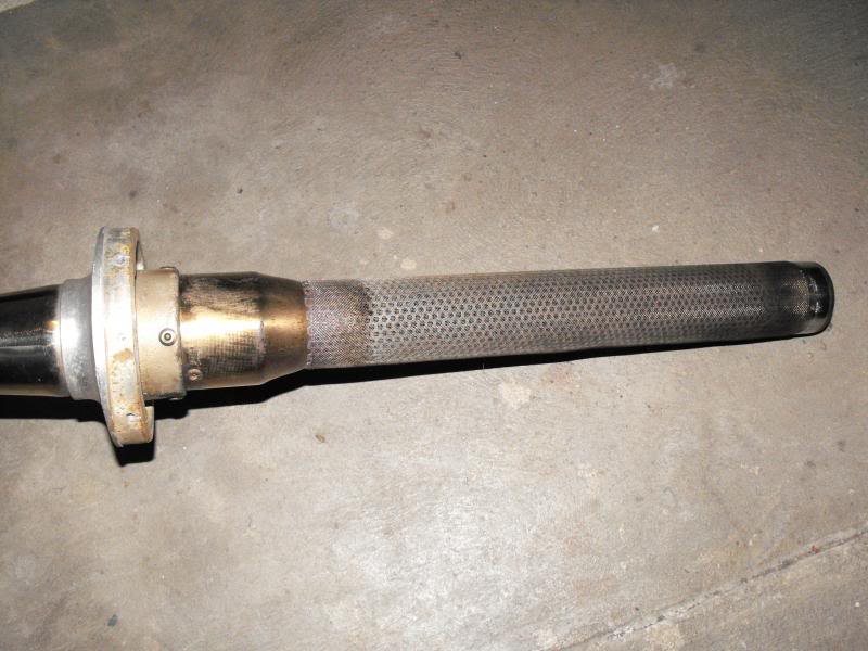

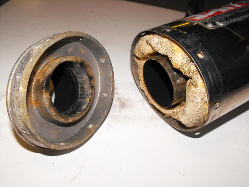

With the same piece of pine I tapped on the centre core tube,
This is the core once you remove the fibre glass matting and stainless steel wool.

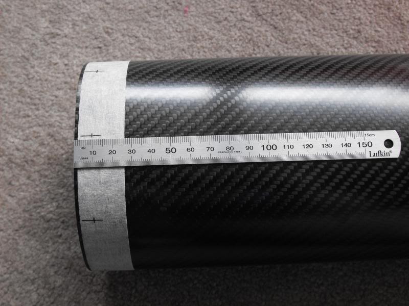

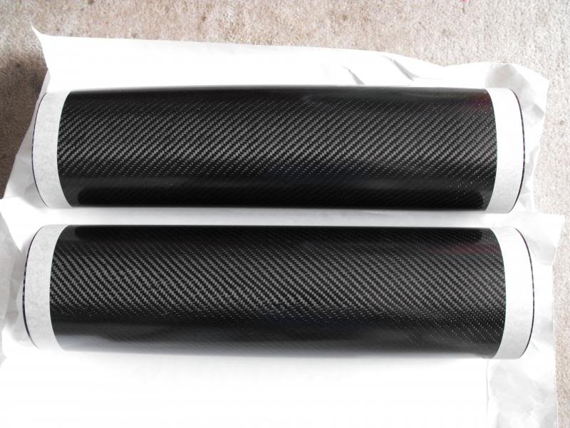

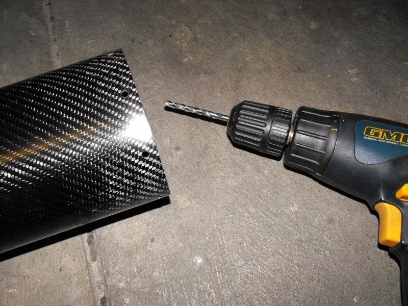

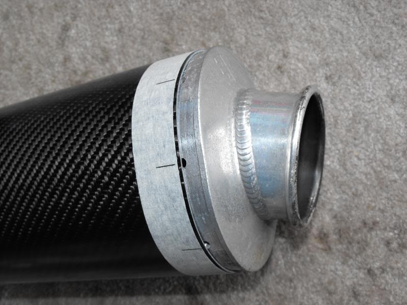

Ok, so I then wrapped masking tape around the carbon sleaves at each end so I could mark up were to drill the holes.
Then put the sleave on the end cap for hole alignment and also did the same for the inlet end.
Measured the hole distance, 9.5mm.
Start drilling the holes. I used a 5mm drill bit.

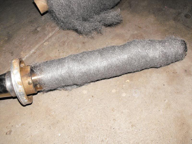

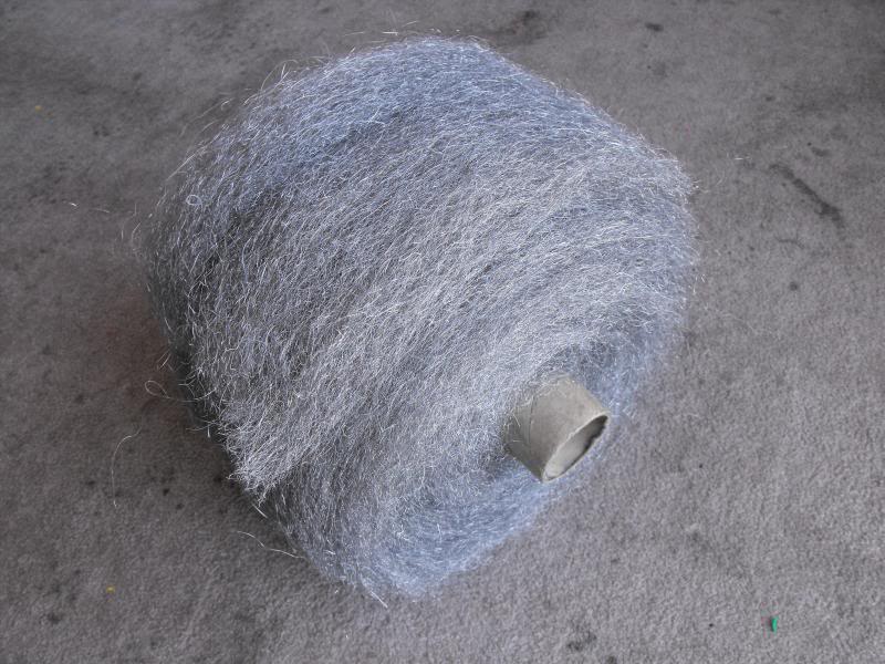

Next step is to wrap the perforated tube with stainless steel wool, I had a bit of trouble getting the steel wool here in Australia, first I contacted Yoshimura, there reply was to try and source it locally, so I tried some bike shops with no luck, next a steel wool manufacturer, they wanted $100, I ended up getting a huge roll of stainless steel wool from a exhaust supplier for like $6.00 , and that is not a typo, just 6 bucks.
Roll around the tube.

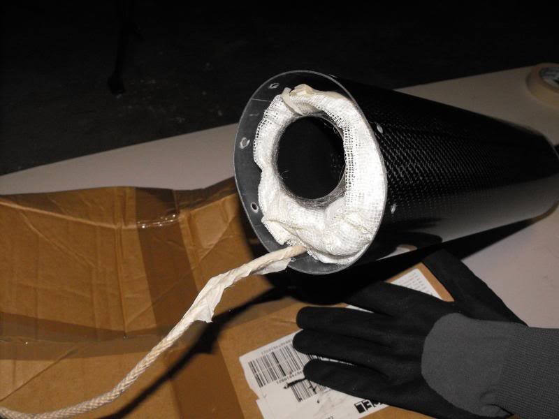

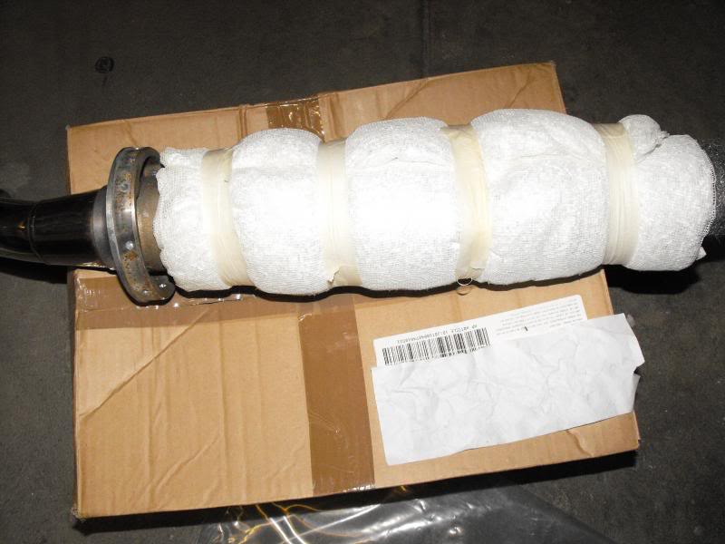

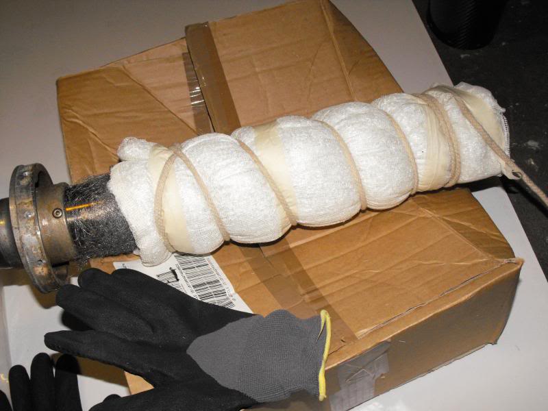

Then roll the fibre glass matting around the stainless steel wool and wrap masking tape to hold in position.
I found a good tip on the internet to make things a little easier, get some rope and wrap over the fibre glass matting starting from the inlet end and working up to the outlet end with some extra rope at the outlet end.
Slide your sleave over and into place then pull on the rope, it will take a little effort but it is not too hard.

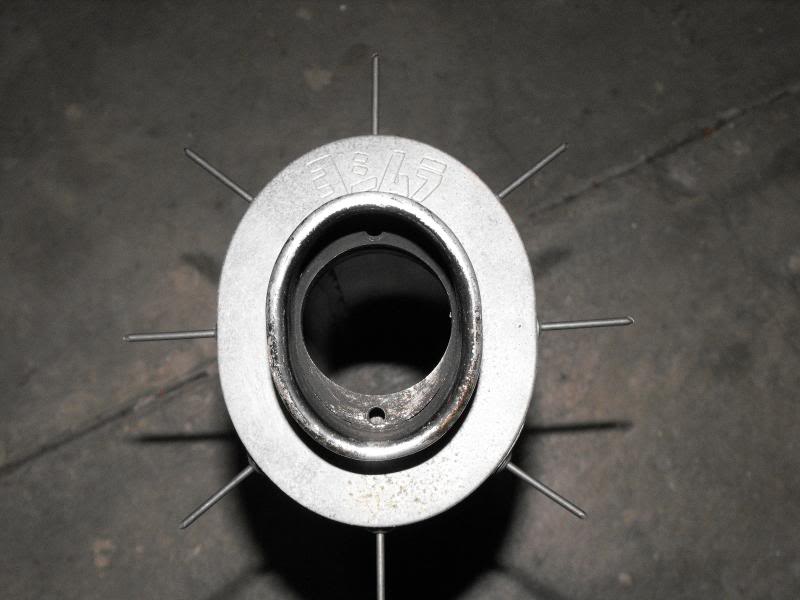

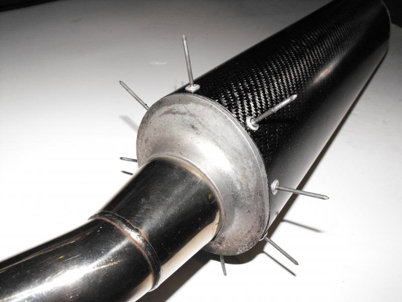

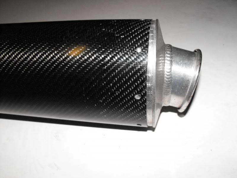

As I mentioned at the start Yoshimura use stainless rivets and I used aluminium rivets, I did this for a few reasons, to start with I already had the aluminium rivets and didn't want to spend the money on stainless rivets (budget build remember), also I only have a hand rivet gun and didn't want to try and pull 32 stainless rivets by hand. I have heard of many people using aluminium rivets on V twins with no problems. So I used sealed aluminium rivets.

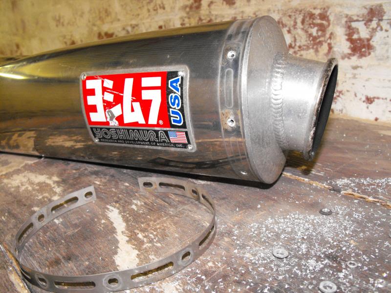

Started at the inlet end and installed all rivets before pulling them. My bands were damaged so I decided not to use them.
Then fitted end cap into position. I didn't take a picture, but I used high temp black silicone sealant on both inlet and end caps, put caps on as below picture then added sealant before pushing inlet and end caps all the way on.
Same as inlet end installed all rivets before pulling them.

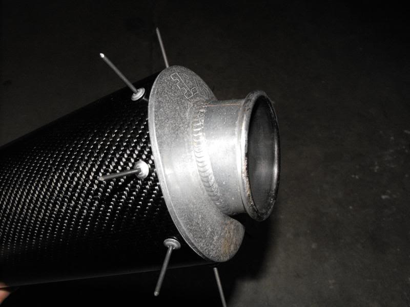

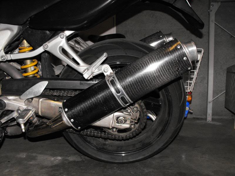

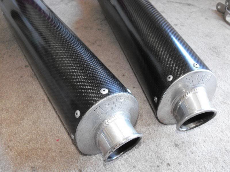

End result.

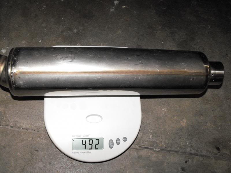

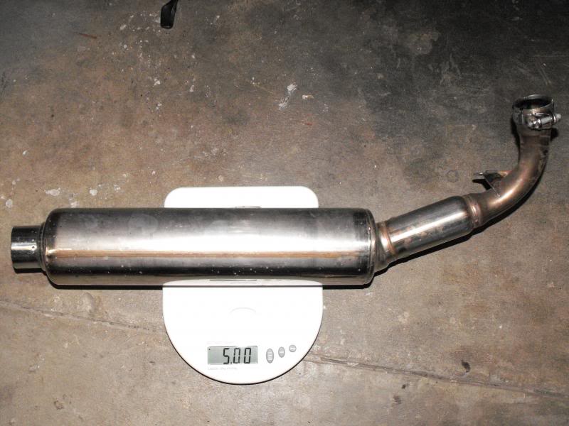

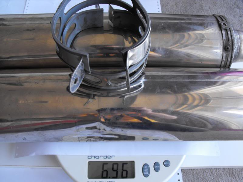

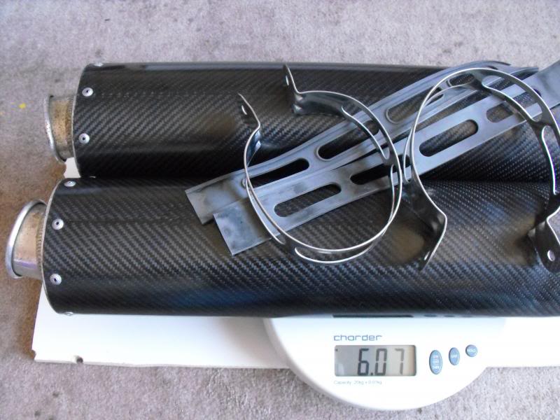

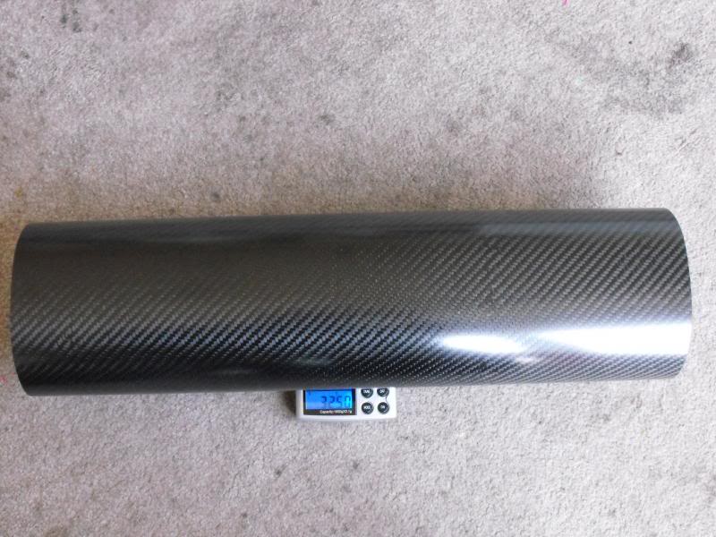

And now for some weights. In kilograms/grams, on medical grade baby scales.
OEM Honda mufflers 9.92kg

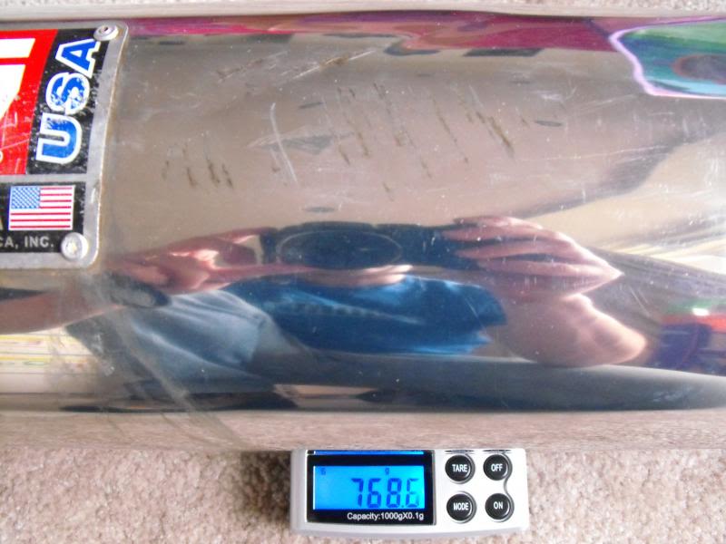

Yoshimura Stainless steel mufflers 6.96 kg
Yoshimura Carbon fibre mufflers 6.07 kg
Yoshimura stainless sleave 768.6 grams
Carbon fibre sleave 325 grams

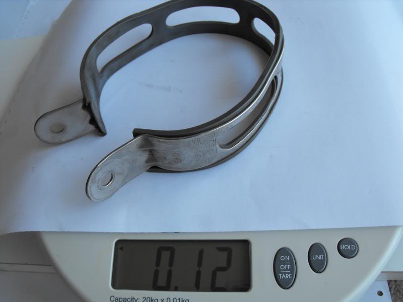

Yoshimura muffler clamp/bracket 0.12 grams
