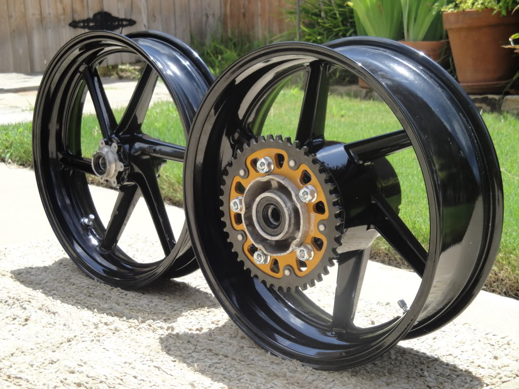

Just wanted to chime in on my install of Dr.Honda's stacks. On my "Seat Of The Pants Dyno", I noticed an improvement. I would recommend them to anyone that would consider buying a set. I had them for a while and just now found the time to install them. Six spokers are the next mod on the way.

What are six spokers and where can I get a set of Dr. Honda's Velocity stacks? I found a website that sell velocity stacks but besides the different heights, is there an actual difference?

Six spokes.
As far as the velocity stacks, you'll have to ask Dr. Honda if he is interested in making more. Check this thread:
