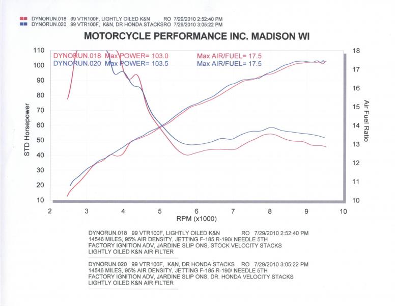

I will be taking the hawk in on Monday for a dyno run and rejet I have before runs from the same dyno so should have some for you guys. before it goes in im going to check the tps adjustment and syn the carbs with the new VS installed the old runs are from two years ago but no new parts have been installed so we should get a good comparison. I am also going to have it weighed so i can find out the weight bias looking for 51% on the front

Well got it their late on monday and they called today about something did not say it was done. I work nights and was already sleeping and it was closed when I seen they called. will call tomarrow but I dont like not knowing what they wanted. GF did not understand when i looked at her and said not now hun my hawk might be sick give me a few. just got that stuped look back. LOL will let you know what is up when I find out ok. if they tell me something when I talk to them I will post but wont have the sheets until I pick it up.

All they have done is put it on the dyno. I put the stacks on and the bike has been sitting for sometime. but I did store it right. Ran 4 tanks of fuel before i took it in.I just talked to them and they want the old stacks back so they can make a run and see if it is something on the bike or the stacks. Its down 7 hp and running rich. I know that some of you are going down a jet size witch makes sense but I want to make sure of the bike before so I can have a good evaluation of the stacks so off to Madison I go. I plan on rebuilding an engine had my heads done on a flow bench. Here is the place doing the work. http://motorcycleperf.com/ let you know what up when I do.

too rich will for sure kill your HP, most car tuners I know try to ride right on that edge of below stoich to almost lean for the most power, not sure if it's different on carb'd bikes. good luck with figuring it out, jets are your main suspect!
Old Jul 28, 2010 | 10:40 AM
Stumpy's Avatar
Joined: Jul 2006
Posts: 655
From: Madison Wisconsin
Exclamation
Yep I agree so I drooped the old stacks off with an extra set of carbs in case I have a bad diaphragm or something. you can see running rich at almost all rpm range so maybe just a rejet will work time will tell.
These guys are good have no worries that it will get sorted out. Just hope I don't have to pay to much. Here is the dyno sheet with just adding the stacks. the only thing they don't have on the sheet is that I have a dyno jet kit installed with K&N air filter. I also adjusted the cam chain so maybe its to tight. adjusted so the noise stops when running - cleaned and re-oiled the k&n maybe to much oil restricting air flow ? told them what I did will know more later time for night night.

holy snoop dogg is your midrange rich!

And that is where most folks go wrong with these bikes. They like to be a touch on the rich side. Tune for torque, not top end HP numbers and you will be much happier with the results...... but of course YMMV

WOW!!!! dropping below 10:1. There has to be something other than just the stacks there.
On the first and second runs... did you also change the exhaust?

No the only change was the stacks. have not heard back anything today they might not look at it until tomorrow or they did and just don't know yet. But when I get the facts I will let everyone know what is up.
imho we will not see any improvement until the rejeting. Just ruling out any other problems form storage but don't think that was the case.

So I just talked to them for a sec as they are still working on it. but I was right with the K&N to much red oil they cleaned it and put a light coat of oil on it and it jumped up 7hp so much for doing it in the dark with my brother helping should always check someone else work but in the end its my fault for being in a hurry and not doing it my self. Blocked air flow makes it rich good slap to the back of my head would help. LOL will tell more tomorrow should pick it up then I hope.

Here is some stuff to look at They did a lot of work to the carbs 28 runs. The tech was not there when I stopped to pick it up I still need the hp / torque comparisons form 2006 until now. remember its had a lot of track days so have to take that into account. but something to look at. I think they will benefit my new motor much more as it will have the head work , higher compression pistons. I want to see how the torque curve pans out as i was thinking that would see the most gains. my best run that I know of was 103.8 hp but don't know about the torque. will let you know. calling them now.
