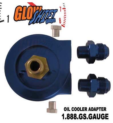

Old Oct 15, 2011 | 09:18 PM
  #40
intoxxx's Avatar
haha yeah
Joined: Oct 2010
Posts: 69
From: 45min SE Orlando
intoxxx is on a distinguished road
anyone ever had experience with using an adapter like this?
http://d3d71ba2asa5oz.cloudfront.net...leradapter.jpg
and utilize it to mount a secondary oil cooler, keeping the original intact?
Old Oct 16, 2011 | 09:10 PM
  #41
I had thought of those but have only seen them for cars..
This is essentially the DRP mod for older V4s.
It can work, I don't remember our specific thread pitch, but yes, you can do it.
I think in terms of cost v. benefit, mikstr found that the RC-51 (iirc) and the same component on an atv were the same and did the same thing with less weight and less cost.
