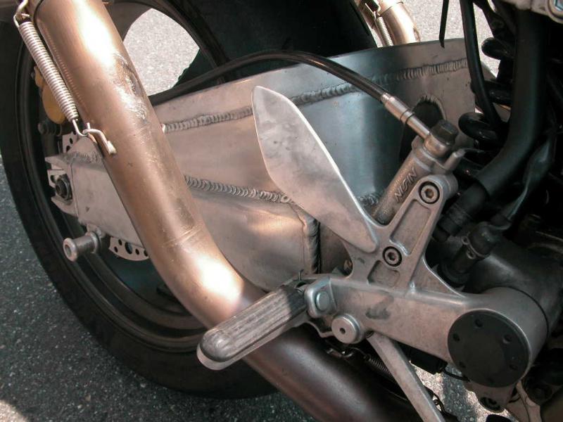

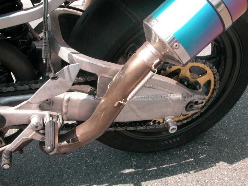

So I wonder what happened to the 2 ST3 bikes Rodger referred to? I'd love one of those sexy swing arms, I bet the weigh 5 pounds less than mine and are about as stiff.

Oops. I wasn't on the last entry. That's the swingarm.
