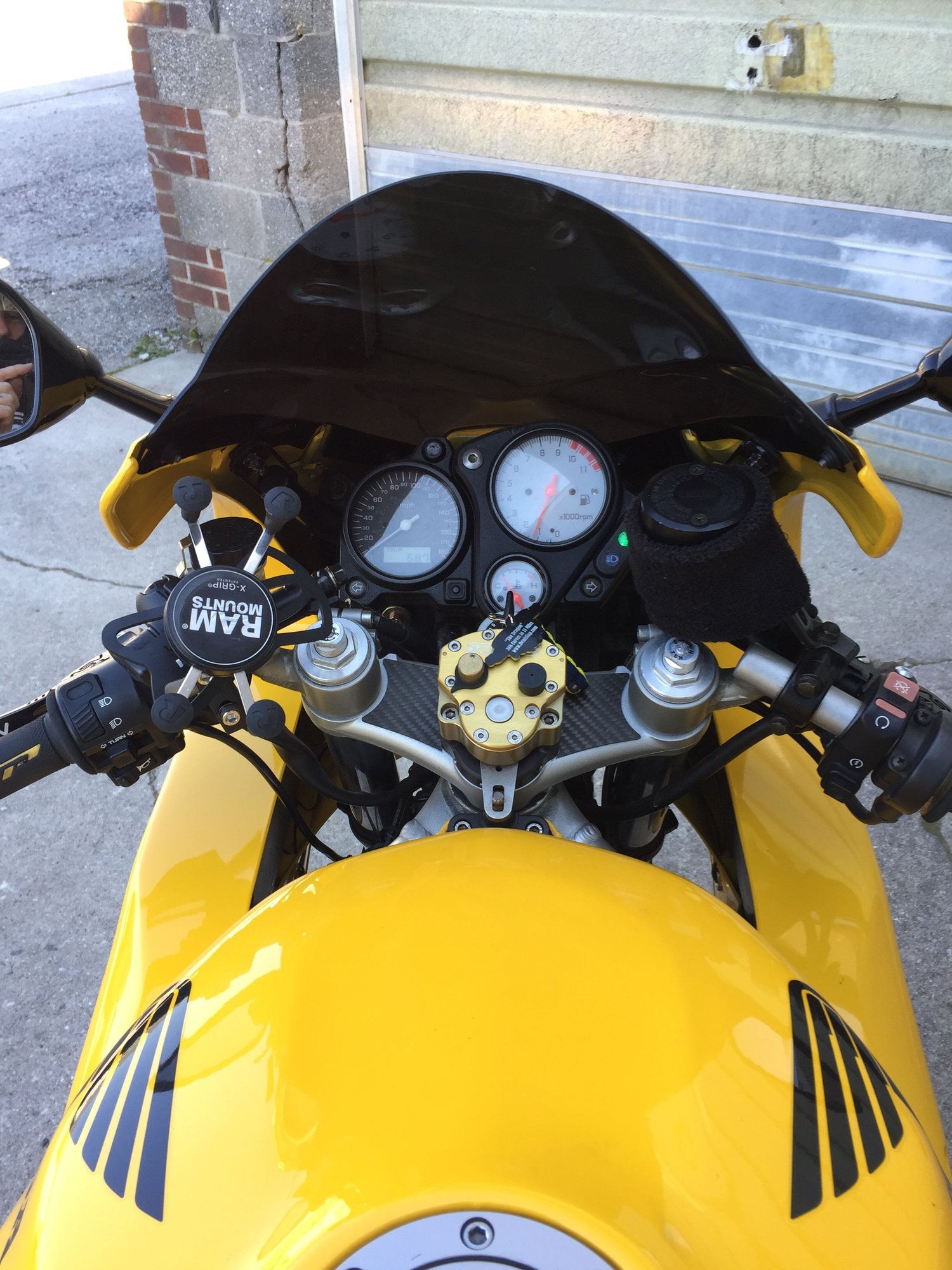

So, I've wanted a damper on my SH for a while, and it is a track requirement in certain places so...
Attached Thumbnails steering damper-damper1.jpg   steering damper-damper2.jpg   steering damper-damper3.jpg
Old Jul 24, 2018 | 02:19 PM
ACE VenTRa's Avatar
Joined: Jul 2018
Posts: 565
The damper itself is off my Buell, it was an aftermarket item that came with the bike so I do not know who makes it. The fork clamp I had made locally, it's a 41.5mm ID if anyone is wondering, and is a copy of the for clamp for the Buell. The rear mount is easy peasy, you just need a longer bolt for the rear radiator bracket. The only issue is that the front brake hose is kind of in the way, but manageable, and I need to make a sleeve for the (M6?) radiator bolt to fit in the (8mm?) hole on the linkage end. It turns lock to lock with no binding or rubbing.
AV
Old Jul 28, 2018 | 04:28 PM
ACE VenTRa's Avatar
Joined: Jul 2018
Posts: 565
Ok, so first ride was today with the damper and I have to say that at speed it is incredibly stable. The nose feels very planted and steering input is basically unchanged. Low speed takes a little getting used to and feels almost like having a binding steering head bearing. A slightly softer setting would likely be perfect if it were possible on my model damper. Fwiw, if you install a damper you should probably get an adjustable one.

Erik, if you need any measurements, lmk. Mine was a welcome addition. I never got stupid with geometry, usually only 5-6mm on the fork tubes (settled on 3mm), but my Hawk had a high speed instability, especially cresting hills where the front would lift a little. Damper fixed it perfectly. And the ease of adjustment is a huge plus. In town and @ slow speed I just reduce it to minimum.

Second ride today was much longer and I was able to focus on how things have changed. I will say that it never crossed my mind to put a damper on the hawk until I found my old one in the tool box. Now that it is on, despite the low speed strangeness, I really appreciate how it feels glued to whatever line I pick regardless of how stupid. The straight line stability is also very much appreciated as well as the reduced twitchiness over crappy New England roads. All in all, 9 out of 10, a Scotts would probably be a 10/10.
My Hawk came with a damper similar to the one at the beginning of this thread. It's adjustable and at the moment set to stiff.
Ive never had a bike with a damper so I really can't say what the difference is with or without.
But the only thing I do not like is how the damper adjusting arm sticks out past the body. 🤨🧐
Ive been looking at the Scott damper as it's easy to get to and have heard about them from years ago reading all the cycle magazines.
Im still learning about the geometry of the bike and 3-6mm seem to be the sweet spot.
How do you go about setting this 3-6mm setting in the forks?
Pardon the ignorance but I'm quite new to this bike and also read about this in other threads.
Thanks all. 👍🙏🏽

So if you loosen the upper and lower triple trees, the forks will slide up or down. Best to have the bike on a rear stand and maybe a jack with a small piece of wood under the oil sump to support weight. The very thin metal ring on the top of the forks stops them from falling out. That is the starting point of adjustments. Very slowly lower the jack until you get the width of a 2-6mm gap between that metal ring and the top of the upper triple tree. I use an Allen wrench for measuring. Retorque the clamps to proper spec to prevent damage/breakage. Another common method is to install a spacer to raise the rear. Effectively producing the results of changing rake and trail.

Thanks l will do the same. Does the end of the damper poke out very far on full right lock?
Old Nov 9, 2020 | 02:45 AM
ACE VenTRa's Avatar
Joined: Jul 2018
Posts: 565
Barely....not enough to matter. I usually don't remember it's even there.
