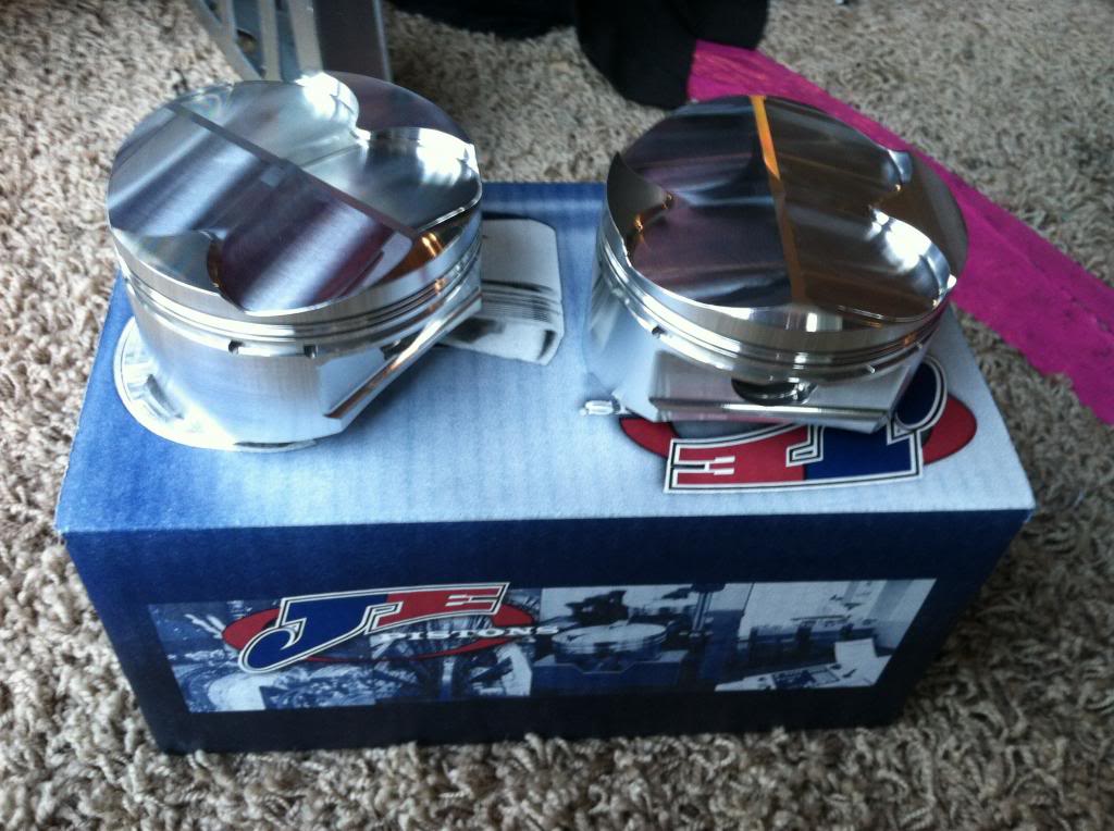

High compression JE 11.5:1 pistons.

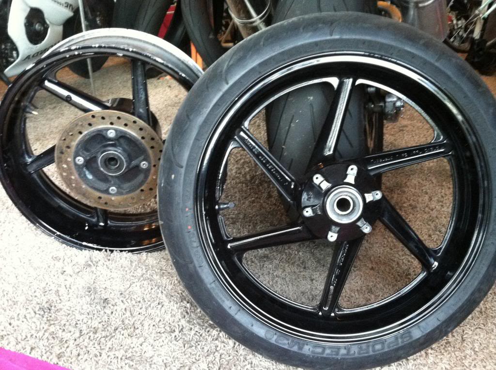

Rear CBR900RR wheel, front SP1 wheel, both for street use, current VTR rear and SP2 front will be for the track.

whats all the OEM parts that i am going to need to install these? i figure its cheaper for me to buy them than to have the mechanic buy them because they always up charge for things.
the pistons came with the pins and the lock rings for the pins. i know i need the piston rings but do i need new con-rods or anything else?
if you could list the numbers from bikebandits parts fiche and how many of each number i will need id appreciate it!

Youll need new head gaskets, RTV for the oil pan... i would think about new con rod bearings, but new con rods arent necessary...
Oh and oil and a filter and maybe some brake parts cleaner to wipe down the gasket surfaces...

the wheels are a direct swap swince i have RC51 forks and wheel already, and the 900RR rear wheel uses the same rotor and sprocket carrier and goes right into the VTR swinger.
thanks for the input on the pistons.ill deffinatley do new con rod bearings. the con rods are freaking expensive to get new tho. yet it seems pointless to not replace them while the engine is open. whats the service life on those? it would be about another $300 for new OEM rods. if re using mine is a bad idea then i wwont. if they arnt neccasary to replace then i will re use them.

Like you, I'm installing 11.5 pistons. I'm going to build up my spare engine, then when the engine build is finished, just swap engines and I'm back on the road with little down time. Good luck with the engine work.

Sorry. I looked to long and hard to get the SP1 wheel. I bought it with hours of it being posted to ebay. I'm tired of paying tire mounting feed before and after each track day to swap my track and my street tires back and forth. It's well wrote the money to have 2 sets of wheels.
Im prolly just gonna pay someone to install the pistons because I would spend almost as much buying the tools needed to do the swap, plus I lack the expirience on internals so I might royaly screw it up. Good luck with your piston install. Go on the RC51 forums. I found a few people selling front wheels but they are pricey. I can give u their screen names if u like

I'm surprised the pistons didn't come with rings, I thought that was standard...
I'm curious what is the width of the CBR900 rear wheel? I run a CBR600 F3 on my FZR race bike, but would be interested if the 900 wheel is wider.
5.5"
