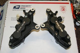

hey guys heres some pics of my newest mod
01 to 02 GSXR 1000 Front Calipers - $85 Ebay
EBC Kevlar Pads - 65$ Denniskirk.com
Huge Difference in stopping power and less lever travel till the brake engages (could just be the new pads tho)
well worth the money even without SS lines and upgraded MC
This a Direct Bolt on, Even the Superhawk Mounting Bolts Can Be Used

was this a direct bolt match or did you have to do any mods to get it to fit?
Old Apr 29, 2010 | 06:45 AM
They are direct bolt on. There is a list of calipers that work in the KB section of the forum.
Also, great deal on those Billzilla15! They are getting more and more rare and finding them at that kind of price is a win!

yea i didn't plan on buying them but the deal was too good to pass up and now that i did i'm glad i bought them

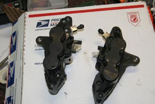

Old Sep 6, 2010 | 01:46 AM
skycam's Avatar
Mad Max NO Squid!
Posts: 54
From: Honolulu, Hawaii, 96789
skycam is on a distinguished road
dam i am pissed off! anybody know what went wrong?
i got a set of 6 piston calipers advertised as 01 02 GSXR 1000 ft calipers "NOT"
i cant believe my luck is there two types or what? these dont fit!
any ideas what these really go to?
Attached Thumbnails Six Piston Calipers-img_9680.jpg   Six Piston Calipers-img_9681.jpg
What is the center to center distance of the mount holes?
Rex
Look like earlier GSXR brakes, I have a set laying in the garage. Same as the ones used on the Kaw ZRX1200 too, have a set of them in the garage too. We were playing with fitting them to the Kaw Eliminator. A friend sent the Kaw set to me and I have to scope out an Eliminator to make the mount plates if I can do so.
From what I've understood from the ZRX forum as well as the Triumph, a lot of those guys replace these specific calipers with 4 piston Nissin calipers for better braking. Seems those early ones tend to have the pistons stick, calling for a fair amount of preventive maintenance. Don't know about those later ones with the offset Tokico lettering.
