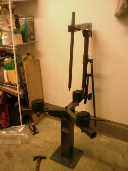

OK, its a generic performance mod.................
anyway, With a fair number of bikes, cars, add in a few track days and I finally got sick of paying for shops to do my tire changes and over charge for tires at same time. Its not cheap, but I figure between myself and a couple good friends with bikes, it will pay for itself pretty quickly. I can now shop for the best price and do the work myself. I know there are cheaper changers but I thnk this is the best out there.
The company is first rate - extremely helpful, free shipping in just a couple days. Everything fits as it should. Really nice family business. If you aren't familiar with this changer take a look: nomartirechanger.com
I just have to drill the floor to mount securely and then can start learning how to use it. I already have two sets tires I need to order and mount up.

Old Apr 22, 2009 | 07:51 PM
Truckinduc's Avatar
Posts: 1,033
I use one at work. Quality product. Hopefully you do alot of the same size wheels. Setting the blocks is the only real time consuming part.
Did you order the spoons or balancer?

the road bikes are all 17 inch rims and that will be the most common ones. I did order the balancer and bars. I have a car I'd like to start tracking and figured this would work for that as well.

My neighbor and I split the cost of a NoMar Pro model a couple of years ago. It's well thought out and nicely crafted with great customer service as a bonus. Being surrounded by chip'n'seal roads it gets a real work out on all our bikes. It's all a matter of technique and lotsa RuGlyde lubricant on the beads and rims.

I have some tires and plan to start learning on it this weekend. Any tips for those using this?

Let your new tires sit out on a blacktop driveway in the sun for a couple of hours. While they're warming up you can pull the wheels off, break down the old tires, clean the bead area and the rest of each wheel, clean the pistons on your brake calipers, clean the swingarm and shock area, and clean the front fender and fork legs. Bring one new tire in and generously lube the beads on the tire, the edges of the rim, and even the drop center. You should be able to slam the first bead down over the rim if it's warm enough and well lubed. Then just follow the NoMar video.

Kept them in the house over nite. These were 120/60 front and 160/60 rear for a honda cbrF2 wheelset I'm putting on my 1100F. But i followed the videos and they came off easy as could be. Going on took me awhile to get the hang of it, and I wasn't using enough lube the first time. Second time much easier - no real drama at all. All together only takes about 2-3 minutes for off and on. Amazing machine really.
I have some wider tires to do next.
