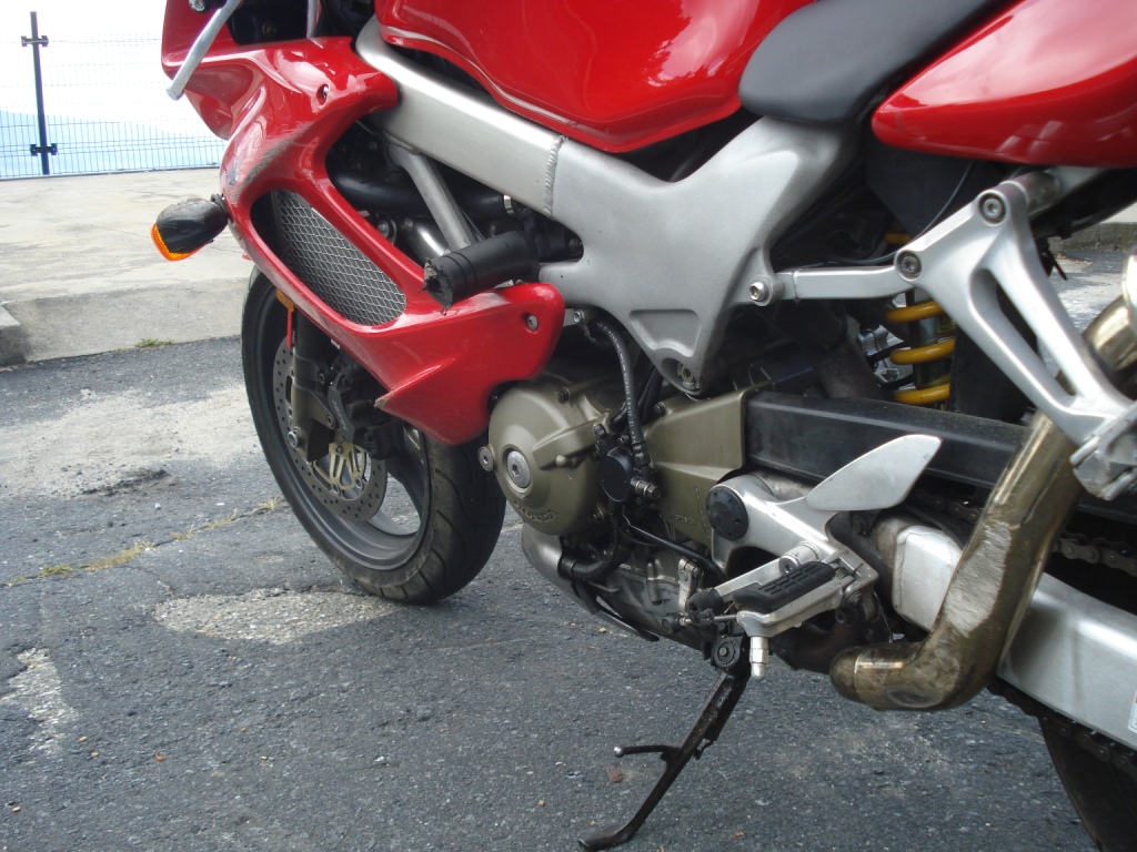

^ heres some scrape marks of the bike sliding into the ditch.
I didnt even realize i had a rasberry, till i parked to take a few shots. The more i thought about it the luckier i felt about the sittuation. It could have been way worse. Lucky for me i didnt wash out the other way off a cliff, or under under a truck or into another rider ect. And the raspberry didnt hurt till i got home and had a mtg with hydrogen peroxide.
Im sorry if the pics of the bike offend anyone, they bother me as well, but on the bright side i wont have to worry about my SH getting stolen now
