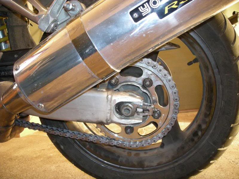

No need to see, just get a SuperSprox Stealth for the SH.
SUPERSPROX USA
Been riding mine since I got home......love the -1+2, and new RK x ring chain, Renthal front sprocket and Stealth rear are doing great.
Old May 29, 2012 | 05:40 PM
SUPERSPROX USA
+1 I'm riding 16/42 with that sprocket and like it so far (longevity I don't know about yet). But the thing looks SICK!
