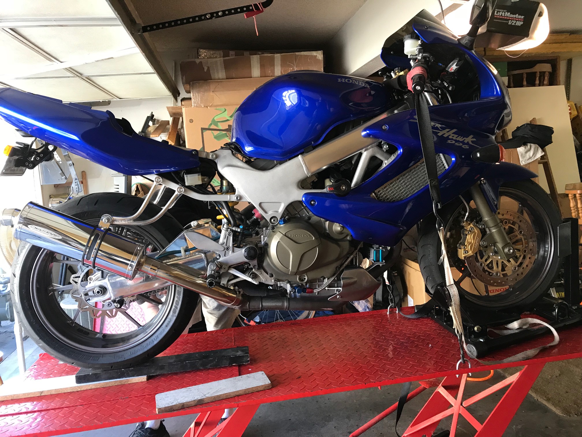

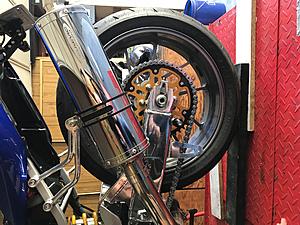

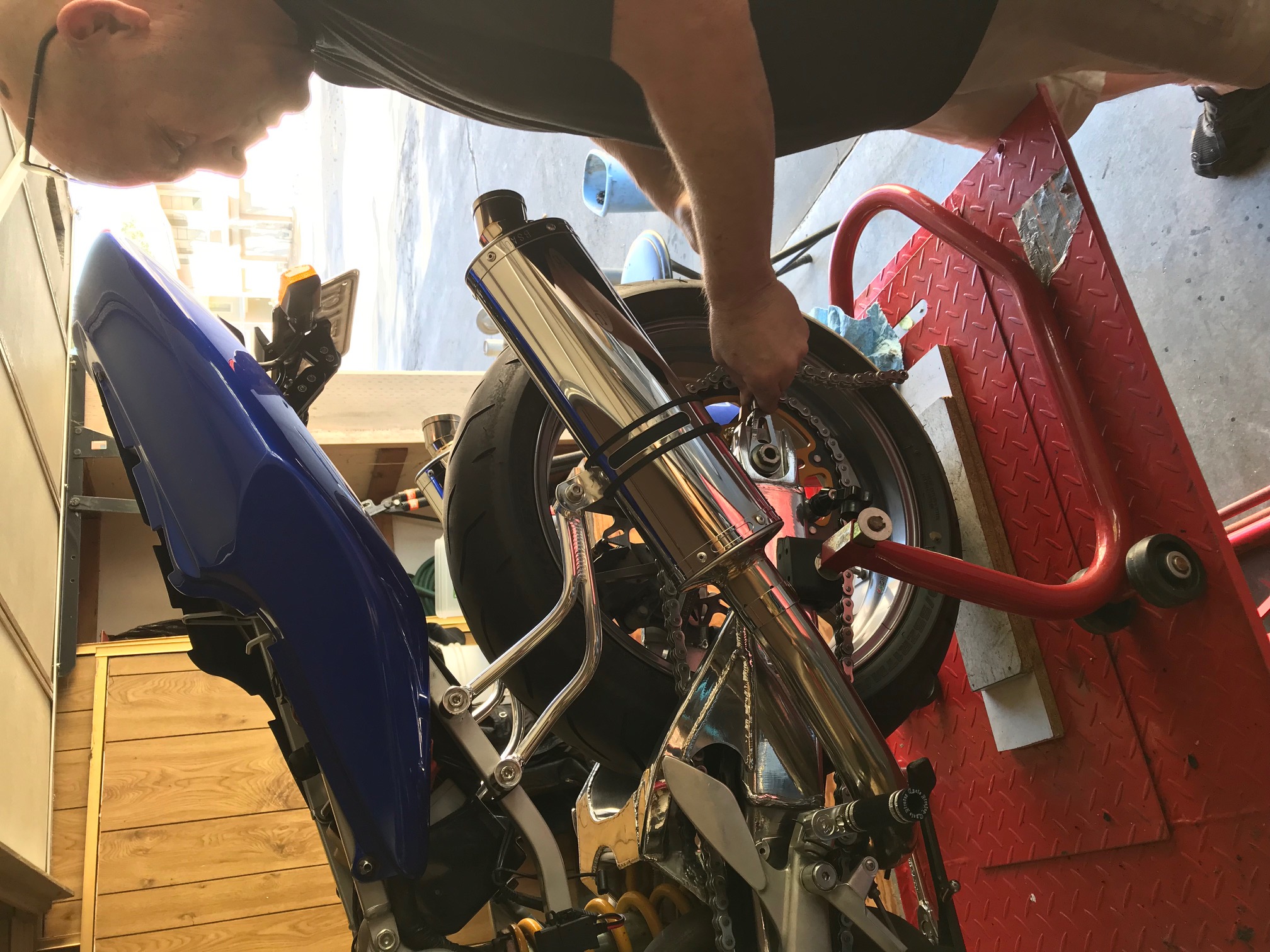

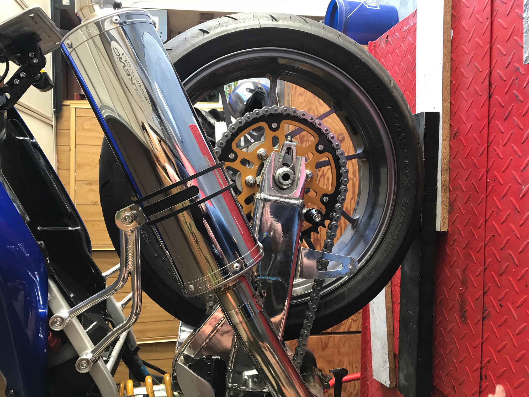

I got a Moriwaki modified swing arm installed today, by my friend, Mike, in Lake View Terrace, CA. I bought the swing arm on eBay, from Japan. I also bought the oil cooler off the same donor bike, from the same seller. (You can see it just above the belly-faring, in the full-view pic). I'm trying to figure it out--the season is changing--but the bike appears to run 10 to 20 degrees cooler for a given situation, with the new cooler. It's a 6-row Active.
One of Jamie Daughtry's shocks is arriving next week, so I'm looking forward to getting that installed, too. I opted for Jamie over Ohlins according to relative value, and the reputation Jamie's work carries.
I've only ridden about 60 'freeway' miles since the swing arm swap so no major changes in handling noted. My expectation is that I won't feel much as I have a stock engine and ride 99% of the time on the street. But, if nothing else the swing arm looks cool.
Mike did the front forks a while back; upgraded with .90 Race Tech springs, 7.5 wt fork oil, and he drilled a 1mm hole in something--LOL. I understand this is a standard mod to the stock forks. After the mod was done it made a MAJOR improvement. No more diving under braking, and a very 'certain' feel in high speed sweepers. It's ample to my needs, as they say.
I'm looking at HC pistons, lightened flywheel, and maybe some 'light' head work in the future. It seems pretty clear from my research that these engines don't give up ponies willingly, if at all, for minor changes. All the obvious stuff--intake, exhaust--appears to be pretty much optimized as the bike comes from the factory.
Also went with a 520 chain, and had that installed today by Mike, too. The problem was I futzed up ordering the rear sprocket and got a 45-tooth. Thought I'd try it. But I don't care for it. When the 41-tooth arrives I'll be swapping to that. If anyone wants/needs a 45-tooth to fit a Marvic/Galespeed wheel, it's yours.
