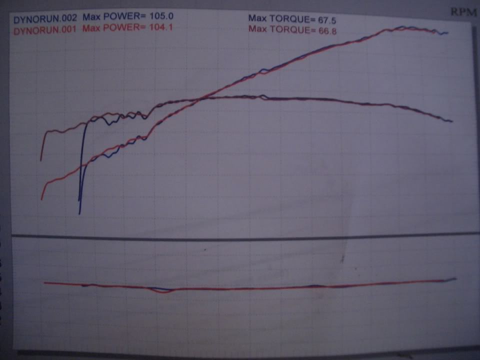

with just jardien high mounts i made 105whp/67wtq. I have since did the jet kit and filter didn;t notice to much difference in power, but overall def smoother.

i can't remember off the top of my head, been a while, but i used w/e ones they said in the directions that came with the jet kit for the mods i had done....
