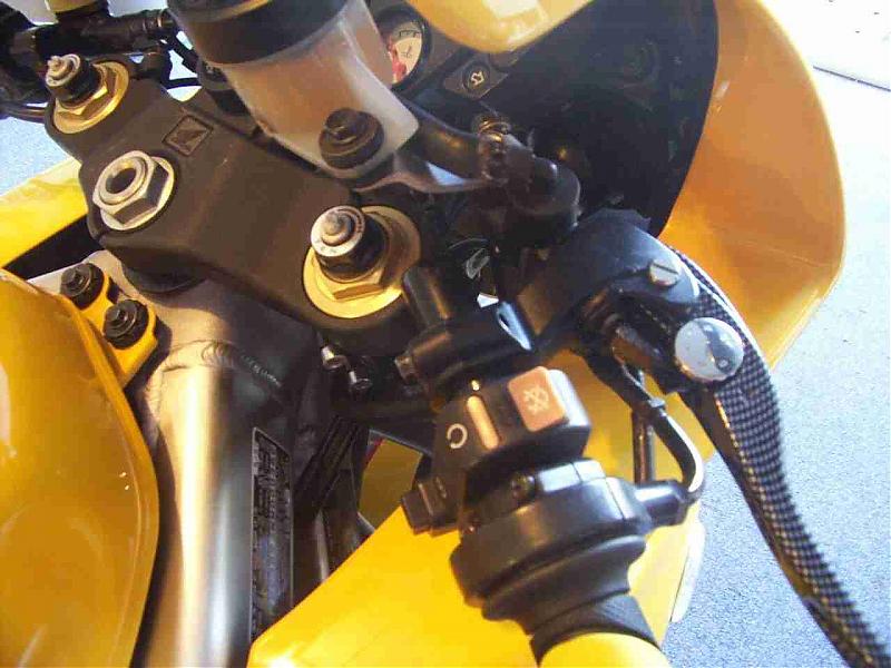

And some Carbon fiber lever!

Final news
First feedback:
This is AWESOME, INCREDIBLE, BAD ***, name it!!!!
I've " finally" finish my project and I've do the tests rides and I'm still not beliving it, this is so cool!
The difference is far away from any of my expectation, the 1000RR fork is awesome, it feel like if the front end is welded on the road, and the brake OMG they are so powerfull!! Even that these radial brake will require a long adaptation time... even after one week, I'm still not acoustomed to have such powerfull front brake ( maybe some feedback from the past two years with the poor stock VTR front brake!! )
Last installation news:
Finally, even with the bran new Helibar, I have not been able to install the CBR1000RR radial brake master cylinder, I was obligate to install the 954 one, but even with this, the braking power is awesome!
My first test ride, show me that the steering was a bit quick due to the short lenght of the 1000RR fork, but it was not unstable, even at 260Km I've test it . I was also feeling the front of the bike a bit too low compare to the rear. So I bring back the bike in the garage and I lowered the rear of the bike of 10mm ( thanks to my Wilbers rear shock with ride height adjustable ). After this, the front of the bike seem to be close to stock ( only in position of course ) and maybe a bit to close thus, I removed 5mm from the 10mm I had previously removed on the rear and now this is perfect, at least at my taste.
The Helibar work very well, this is sure that the riding position is a bit more leaned forward compare to the stock VTR setting, but even if the bars is lower, the position is still less radical than a "pure" sport bike. This is sorry that the 929 Helibars are not only 1/2" higher like this they would have been perfect, maybe I will modified them later, will see...
The hardest part of the final modification was to bleed the brake! Because I have been obligated to change the 1000RR master cynlinder by a 954RR one and I've also replace the VTR cluth master cynlinder by the 1000RR even if they seem to be identical, the 1000RR was more "younger" and I though it should not be a bad thing to change it. In fact, the best thing I've do is to change the cluth and brake oil! the "old" oil was so dirty compare to the new one!!! It's sure that just this have make a big difference. Even that I recommend to any pre 2000 VTR owner to also change their brake and clutch oil, it worth the effort for sure.
To make the bleeding more simple, I've bought a little tool on ebay and it work very well!! I would not imagine how it should have been without this! At first I was thinking to buy some Speedbleeder but the bad thing with them it's that they must stay on the bike you are planning to bleed the brake, compare to this little tool that can be used anytime anywhere, I good buy IMO! http://cgi.ebay.com/Aeration-des-fre...QQcmdZViewItem
The throttle cables give me some little trouble, but thx to Superhawk22 for the advise about this, it finally worked well.
In conclusion, this CBR1000RR front and swap is a very great succes, the difference compare to stock is very awesome and worth any penny and any time I put on this, IMO! If this is over for the front end, this is not over for the bike modification, I'm planning some change to my Micron pipes and I will go make change the bike striping next week. But for now, I enjoy any ride like I never do before!
Don't be shy if you have any question about this mod, I will be please to help and/or if you would like to see a particular picture just ask, I've abused of the digital camera during the mods! :-D
Cheers

Final pics of the assembly
Attached Thumbnails -icebuds-swap-31.jpg   -icebuds-swap-32.jpg   -icebuds-swap-33.jpg

last pics
Attached Thumbnails -icebuds-swap-34.jpg   -icebuds-swap-35.jpg   -icebuds-swap-36.jpg

why did u use 929 top triple clamp and 954 lower triple clamp? couldnt u use cbr 1000 upper and lower triple clamps instead?
