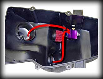

It looks a lot like this (taken from the mfrs's WEb site; pic is for an Aprilia RS250) although on the VTR the tubing runs outside of the velocity stacks. Hope this helps.

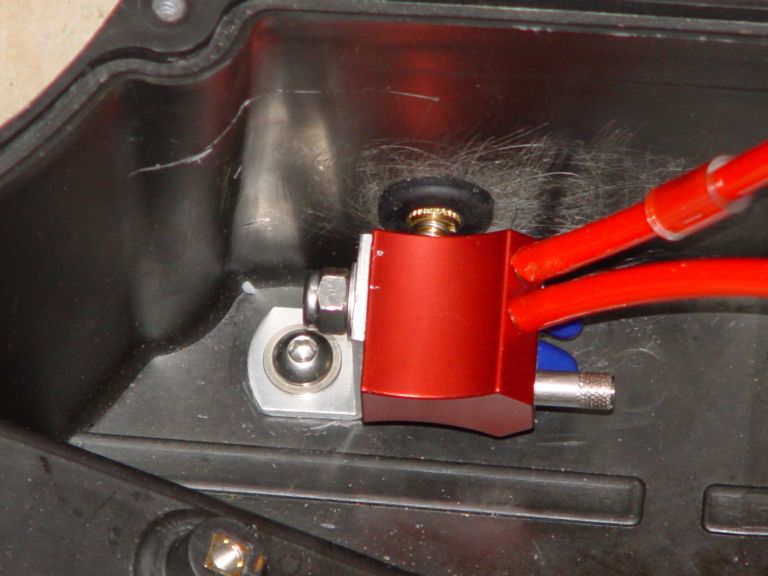

I don't know that I would do it again. I think it's a useful tool and can compensate somewhat for atmospheric changes, but it's not a substitute or alternative for proper jetting.
Attached Thumbnails Flo-Commander, to do or not to do-dsc04344.jpg   Flo-Commander, to do or not to do-dsc04343.jpg   Flo-Commander, to do or not to do-dsc04335.jpg   Flo-Commander, to do or not to do-dsc04326.jpg
