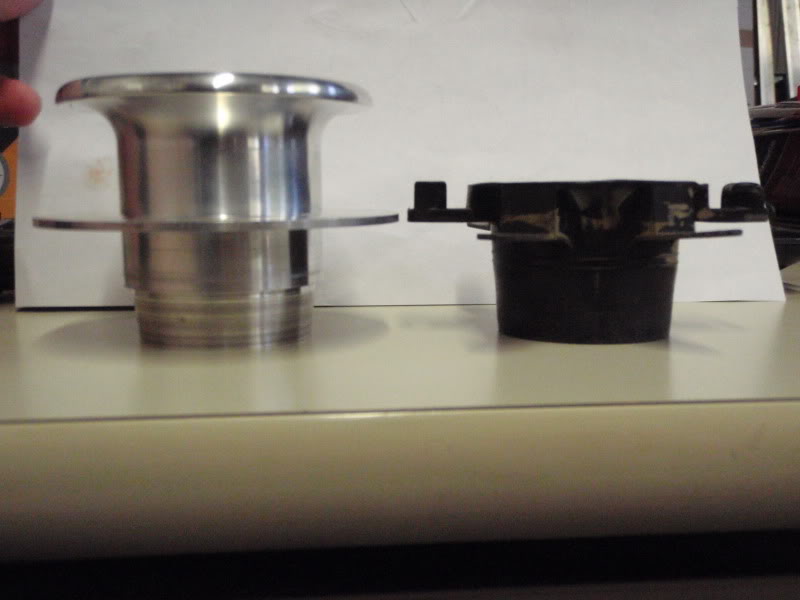

Originally Posted by reaper
31 set and counting......Dr Honda any updates?
Yes.
Sorry, got tied up with an emergency. Not mine... a customer. (good money when that happens)
OK... here's the deal. I got the report back from my test fitter that there were a few issues. But, then I was informed by a few other people that the flange must be trimmed (by the installer) to make clearance for the air box stuff.
My test fitter sent a factory stack to me to get measurements from. (thanks for your help so far) As far as I can see... the base of the stack, to the flange (mounting point is correct, and so is the tapper, and OD of the part that goes into the carbs. My only concern (Before I go into production) is the lip that is about mid way between the tapper, and the mount. (pic below) Since I didn't make the CAD model, and since I don't have a bike in my shop... I don't know if this is a problem. I was thinking that it may be hitting the plastic airbox.
Should I cut this down? Should I round it off??
If some one with the original group buy can let me know... that would be great. OR... if there is anyone in the Pittsburgh area that will let me do some test fitting... that would be even better.
Does anyone have a picture of the original stacks, not mounted into the bike? (So I can see the base)
Sorry this is taking so long. I just don't want to make up 31 sets, and then have to scrap them because they won't fit.
The Lip in question.....

That lip won't let the billet stack sit flush with the carb throat, but it does appear in this thread that the HP Power ones have the same ridge. I figured that since the stock ones sat flush, the HP/billet ones should too.
Old Jun 3, 2010 | 05:33 PM
  #73
Exclamation
Sorry, but wrong... They do sit flush... Read from post #51 to get the full picture, and note the difference between "flange/ring" and "ridge/lip" or whatever people call them...
Old Jun 3, 2010 | 05:36 PM
  #74
Syclone's Avatar
Boosted
Posts: 642
From: Sioux Falls, SD
Sorry Tweety, but the ones from Dr Honda didn't sit flush. That ring (with the Sharpie arrows) kept it from going all the way down into the carb throat. I tested it. The mounting ring didn't touch where the nuts where the stock ones bolt in either, it was off by ~4mm.
I am assuming it's not supposed to be that way, but can you confirm that? I'm assuming that the billet stacks should sit all the way into the carb just like the stocker, and that the outer mounting flange should rest on the stock nuts, just like the stock ones.

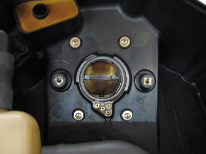

Old Jun 5, 2010 | 09:27 AM
  #81
bjorn toulouse's Avatar
Destructive Tester
Posts: 263
From: N.E. oHIo
ATTN: Dr. Honda
I have my airbox open for some fettlin', so I did a few measurements.
If the info helps, cool.
Here's a shot of the rear cylinder carburetor throat.
Note the 3 areas where the base of the airbox covers a portion of the carb inlet surface. This may be where there is some interference with the shoulder above the base of the velocity stack.
The thickness of the airbox base to the carb inlet face is 5.5mm, the depth of the taper in the carb body, from the carb inlet face to where the stack should seat is 13.7mm. (measurements made with a Mitutoyo depth micrometer)
If the taper to the shoulder you have arrowed in your pic was 19.2mm, or a bit more, from the base of the stack I believe you would be in business.
Rex

That's kind of what I was thinking. The drawing, and my part have that lip at 16mm to the base. I was kind of thinking that it may grab inside the plastic of the airbox.
I may just add a second tapper to it, to give the air box base a little more clearance.
This would be so much easier if I had a bike in my shop.
