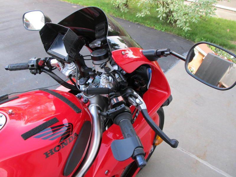

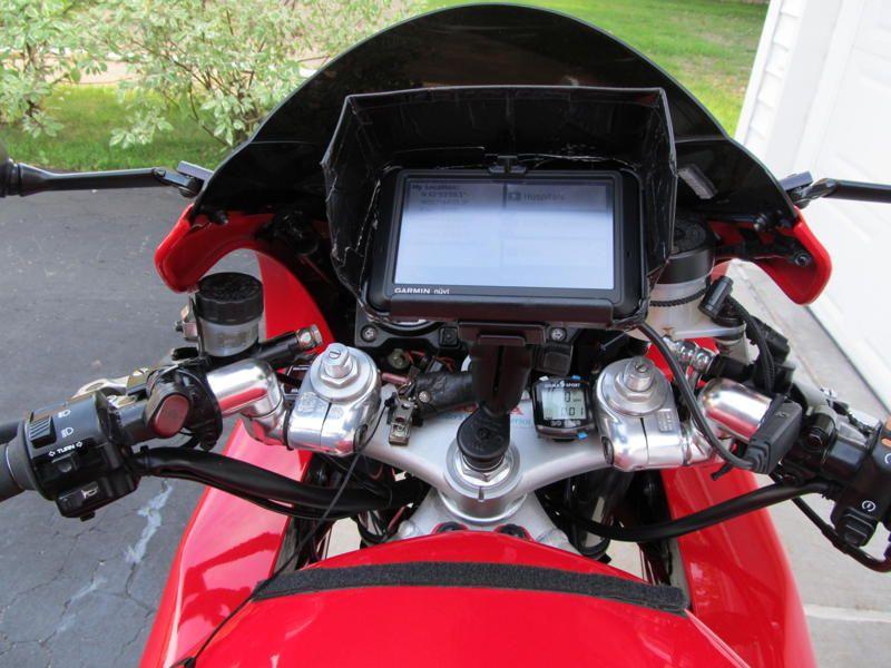

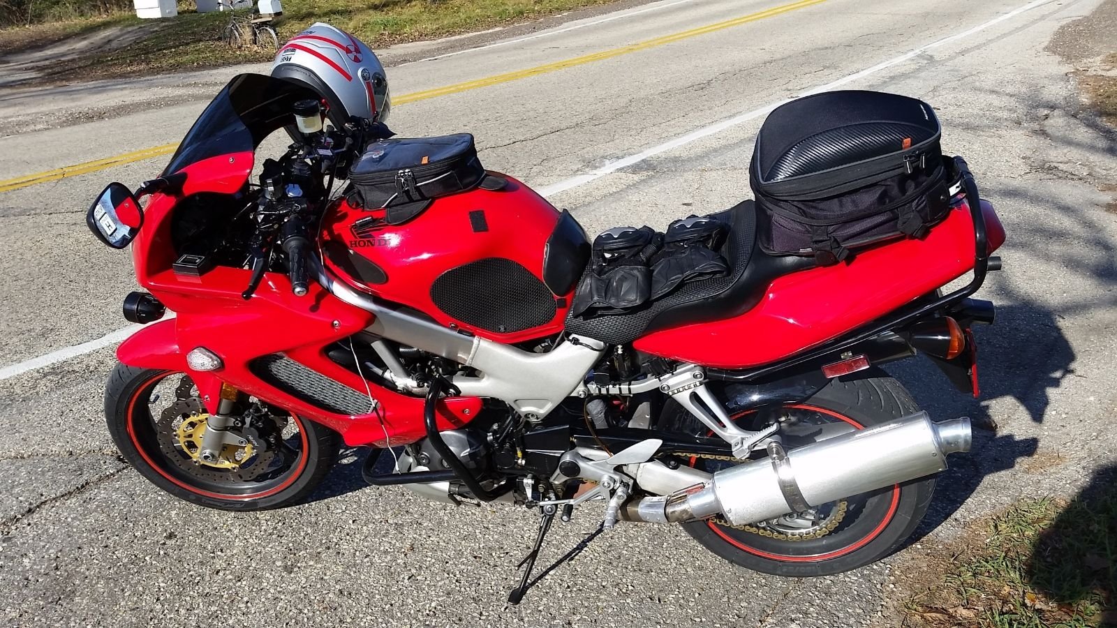

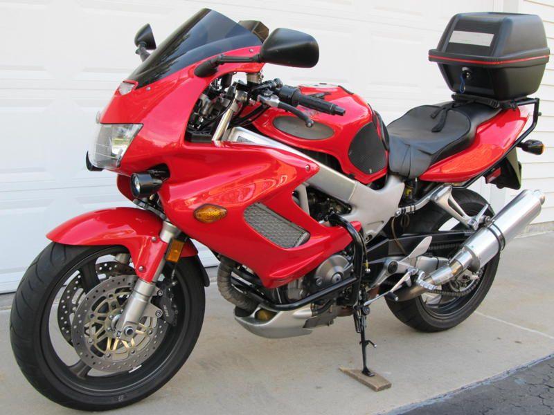

I commend you on your efforts to date, I've done many of the things you have over the last 27 years and hundred and eleven thousand miles on my fastest red ninety eight
A few comments on what you've done, and suggestions on what you haven't, yet.
Your fork brace is impressive, as arr your shift shaft brace and can hangers.
Back in the day, I just went with a Superbrace, black, of course, it was special order then but no longer available.
https://superbrace.com/pages/honda
Many moons ago I also installed the long intake funnels but haven't noticed that big of an improvement
Jetting the VTR can be tricky and don't fall into some of the suggestions like a epoxying closed one of the lyft holes in the slides and going too large on the pilot jets.
One of the reasons I asked if you were in northern Italy, does it get cold enough there that the carb heated water system could be important until it warms up? They're a bitch to clean and parts are no longer available but i've kept mine. I have six sets of carbs that I swap out every few years and two ninety 8s, 1 is for sale. I also have two spare engines and enough parts to build another bike including a frame.
The stick coil mod is also a very good idea.
However you didn't quite go enough when you removed the pair system. You should remove the little covers in each valve cover, clean disassemble the reed valves, flip over the reed stop, seal the reeds down with HT silicone ( including the heads of the little screws that secure the reed stops, and butoon it up after plugging the hose nipples also with HT silicone; little ugly rubber caps then not required.
I also added a second horn by just splicing in AY splitter to each horn and found a relay is not required.If you use the fiamm low tone pancake horn.
You also did a smart thing by relocating the VRR, but you didn't replace it with a mosfet unit. Replacing the OEM wiring with a heavier gauge wire direct to the battery an adding a inline fuse and waterproof connectors ( the thin oem red wire to the battery can be sealed or used as a power wire to an auxiliary circuit) is highly recommended.
Also, feeding the headlight direct directly from the battery, with individual relays for the high and low beams, and just using the power wires to the headlight for triggering the relays. This gives you much better anchorage to the headlight , which I replaced witha H4 LED "bulb" from Cyclops.
I also replaced every single incondescent bulb with an LED bulb and added a low voltage draw flasher relay for the turn signals.
I also have a unobtainum Ventura - MCA headlight lens protector.
I also installed another pair of OEM front turn signals in the rear AND ADDED A POWER WIRE FOR THE THREE WIRE BULB TO HAVE REAR RUNNING LIGHTS

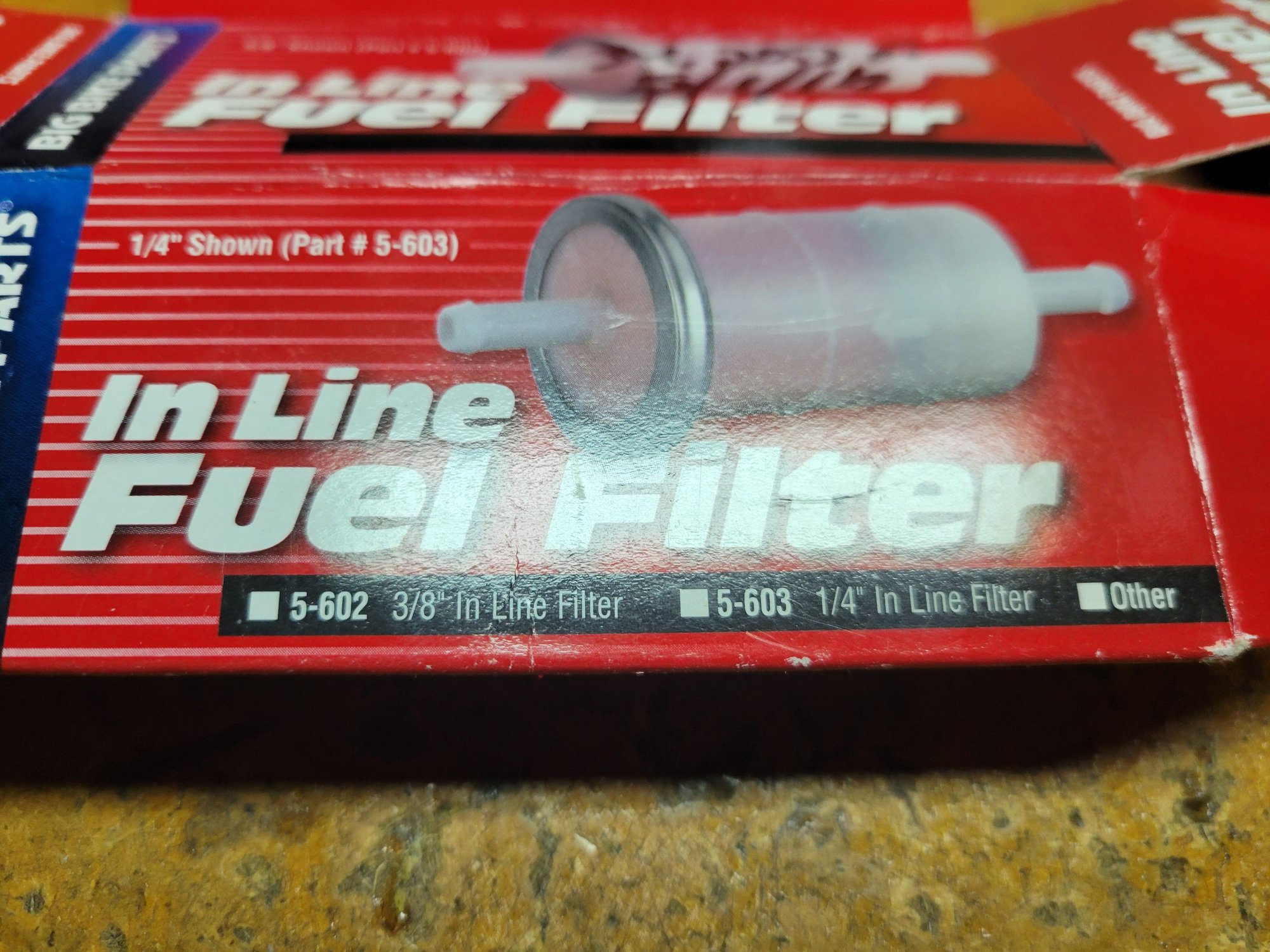

Another smart modification is putting an in-lne fuel filter in each fuel tine to the carbs drom the tank. I also put in an inline check valve and P-trap in the fuel tank breather line which prevents "vapor lock" when riding in heavy rain when the end of the hose down by the chin fairing is submerged in water. I recommend keeping the chin fairing to protect the engine and oil filter from road debris, and adding a front fender extender.
I believe I saw that the front brake lines were replaced with stainless steel- teflon lined hoses but it appears the rear brake line and clutch line have not been replaced, which for any other reason than due to their age is a good idea.
On the topic of brakes, have you replaced the front pads with HH+? For the rear pads, I actually prefer low friction items on the VTR...

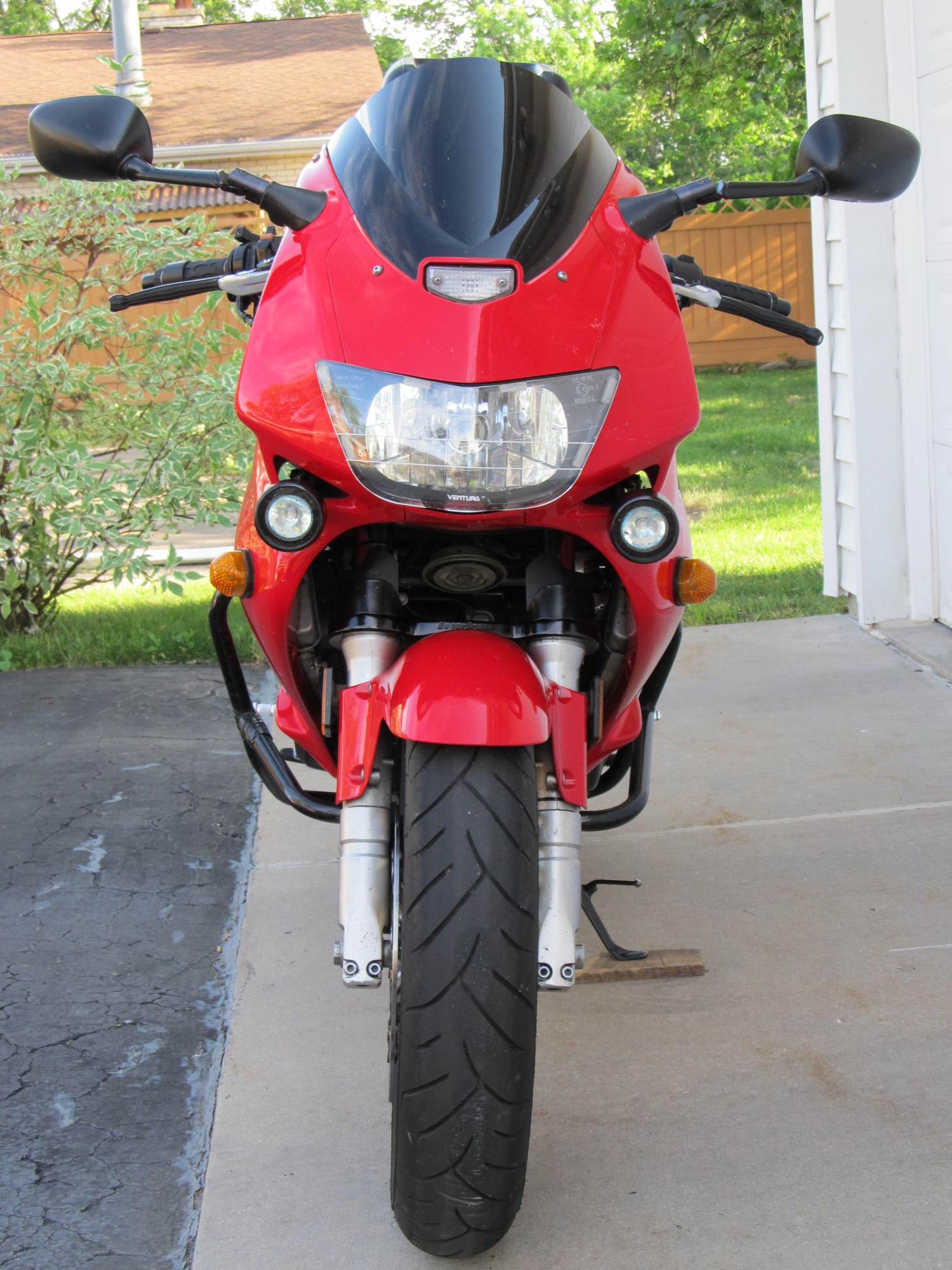

I also installed three axis adjustable and taller clip-ons and mirror extenders.
My pilot pegs are MFW Varios which permit 360° adjustment; I lowered and moved mine forward for more leg room along with my taller, cushier and better fitting custom saddle.
I have period correct Two Brothers aluminum C2 oval low mount slip-ons but cut out the restriction in the collector pipe that blocks flow to the right can.
I've also added several new electrical circuits for auxiliary brake and side position lighting.
I also run a 2 tooth larger rear sprocket, and a Scott Oiler
I'm sure I've forgotten to mention a dozen + other "improvements" I've made to my sweet old ninety eight, which they'll have to bury me with!

PS attached is a not up todate list of my mods on my fastest red 98...the have been a few significant additions sincee 22

Think about GL1200 fuel filters, they're cheap insurance...
