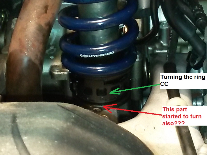

Anyone successfully adjust the preload on their DMR (CBR600) rear shock?
I bought the CBR600 spanner. Tried using a ladder and straps on the subframe to take some load off the spring but that sucker doesn't want to move.
The whole bottom assembly starts to move (see pic) so I stopped because I was afraid I was going to break something. I was turning counter clock wise for less pre-load.

can you hold that notch on the lower part with something?

These are obvious. And hard to move. The bottom bit turning is normal, it is captured. It cant go anywhere.

3) The lower part of the shock can spin and it will not hurt anything. Just stick a screwdriver in there to align it with the upper mount for installation.
