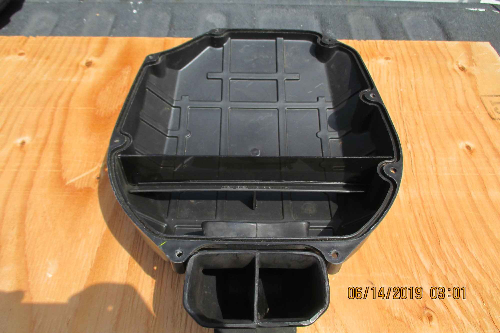

So any pics of your custom air dams/ spacers / setup? Sounds tuned to the job.
I have a k&n laying around that of course didn't ever work right.

Smokinjoe, I'll shoot some pics of my dam tonight and post them.

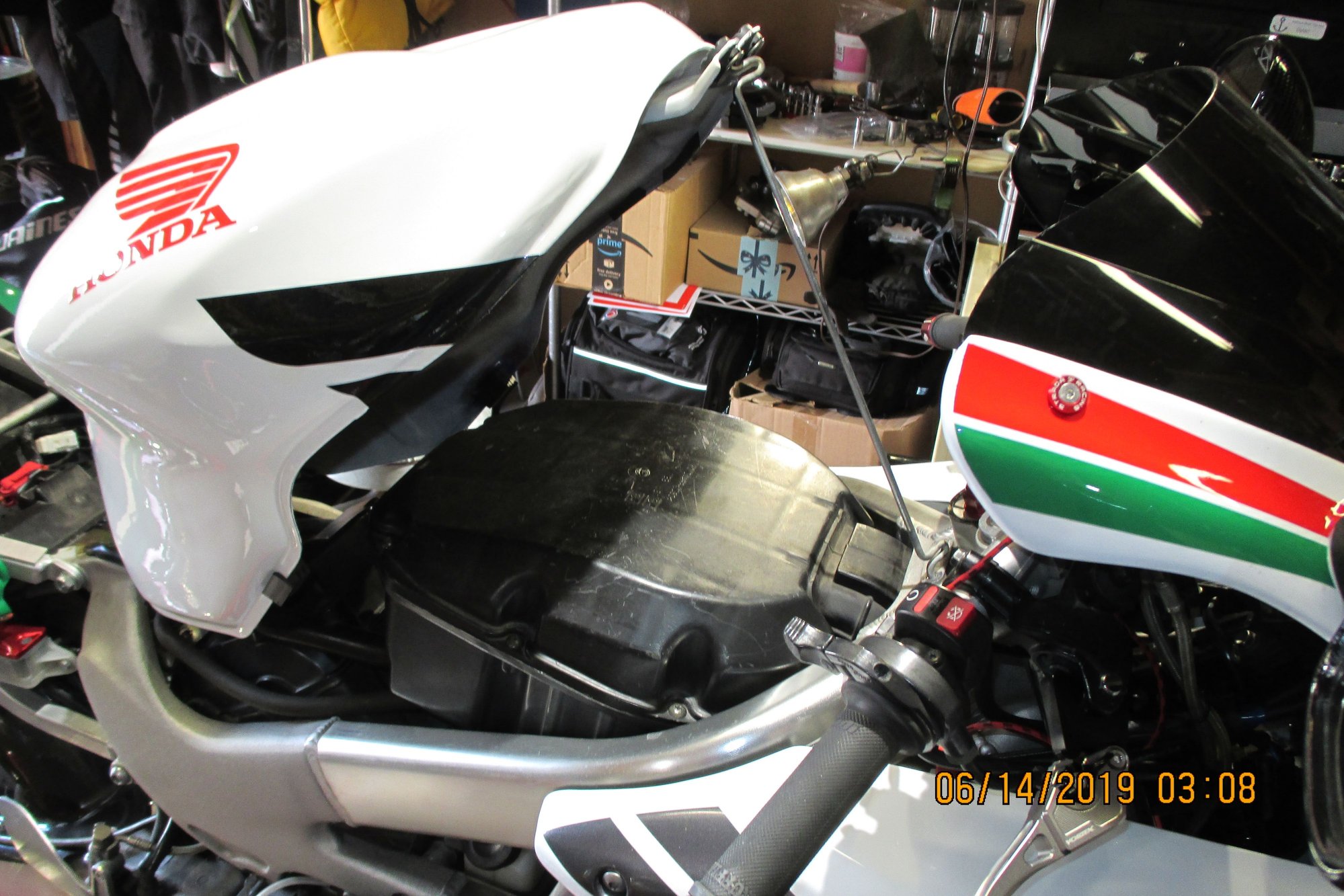

Smokinjoe73 Here you go;
OEM filter w/dam, Air box lid, K&N, Air Box w/ added dam, and in she goes.

And yes, VTR tanks can be tilted without disconnecting any lines. Makes it easy to service, sync, pull carbs Etc.

And don't try it with more than a half tank of fuel!
