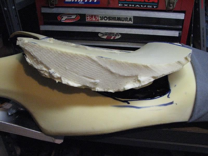

First pic is the stock foam that was remove via an electric carving knife.

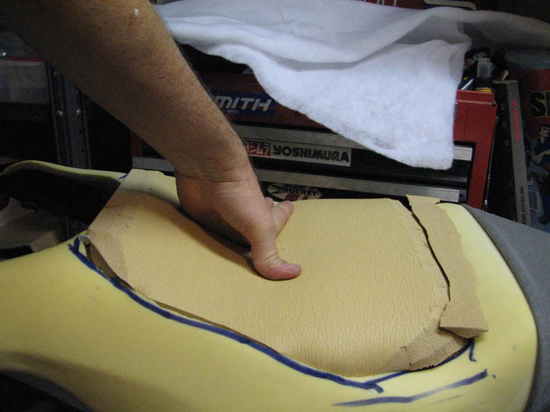

Second pic is the sargent foam being formed and placed back in. Use knife and sand paper to get a close fit.

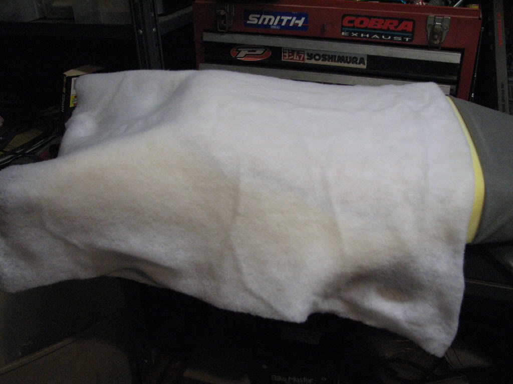

Next I covered it with some cotton batting source from walmart's fabric section to smooth everything out. Pic was taken before trimming but leave enough to pull tight underneath to staple along with the cover.

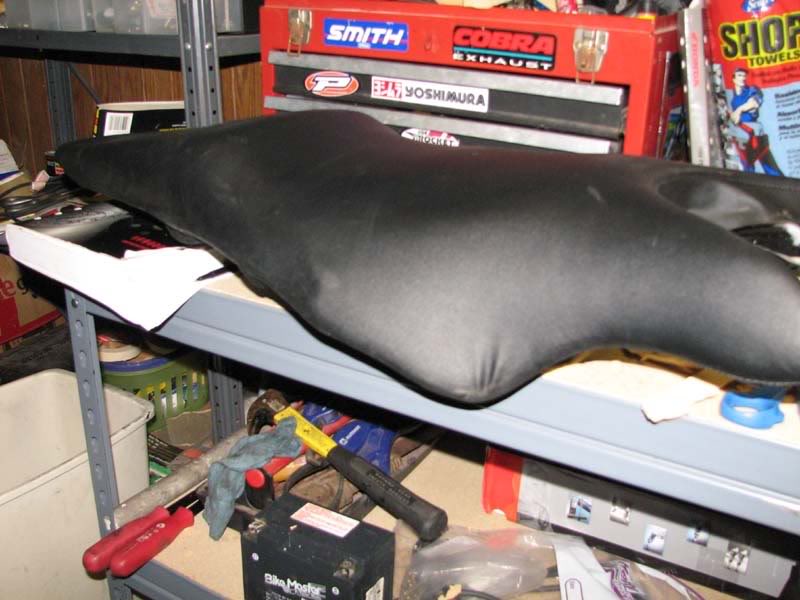

Close with a heavy duty stapler while pulling the seat cover firm. This is my VFR seat but it's the same for the VTR.
