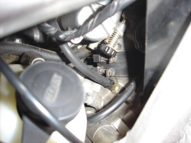

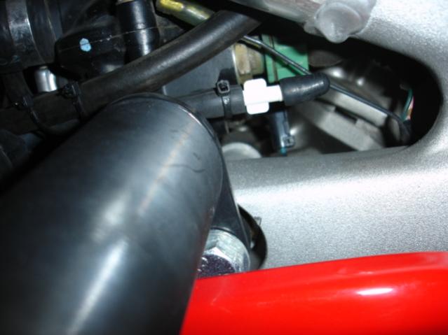

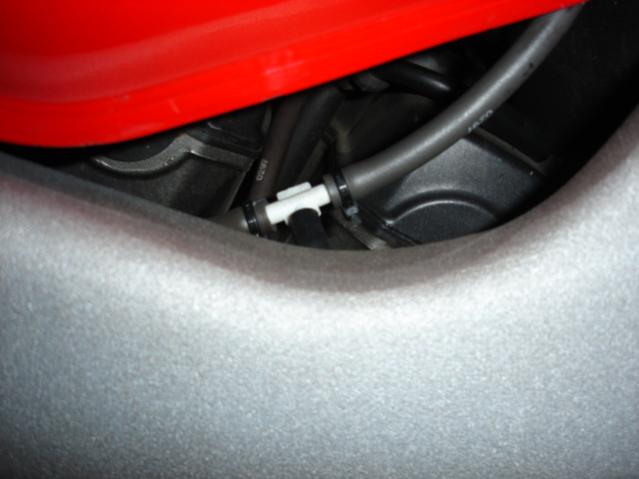

Okay I will try a tank of 87 and see if there is any improvement before digging into the carbs.
Tweety, I have the bike setup now where all I have to do is remove to rubber caps and attach the vacuum hoses. Simple as that.
Honda part #16214-MB0-000 joint booster $3.77. This replaces the hex bolt that sits below the carb housing on the front cylinder head and $0.50 worth of hose to complete the job. Sync the carbs all day long with no hassle.
