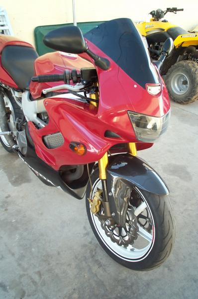

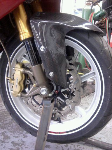

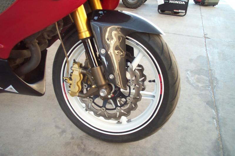

After many months of reading and cross reference I had accumulated all the parts needed to perform a USD fork swap. The parts had been sitting on the wall collecting dust for sometime now and so I figured what the heck.
-forks are zx10r
-calipers are gsx1000r
-front wheel is cbr600f3
-rotors are galfer
-front axle stock 20mm superhawk

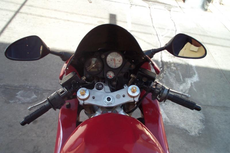

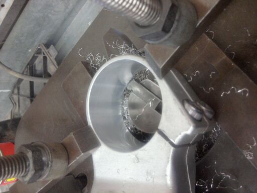

-triple clamps are 2009 r6-(bottom clamp bored 2mm over to accomodate 54mm tubes-top clamp fit correctly)
-clip ons are danmoto adjustable
-zx10r carbon fiber front fender
-bottom steering head bearing is all ***** tappered needle
-top steering head bearing is from an sv650 racing site and was a couple mm too short so I shimmed the bearing race inside the frame (all ***** no longer had the exact bearing dimensions available)
I had chose the r6 clamps because of the rotor spacing so I could keep the same wheels/chose the zx10r forks because of the 20mm axle diameter and due to recommended rider weight. Everything else just kinda filled in the gaps.
I have yet to tune and adjust them and have only run them around town a little-I have the rear end to do yet-have a jd shock and braced swingarm I'll put on here shortly
Attached Thumbnails ANOTHER FRONT END SWAP-vtr-003.jpg   ANOTHER FRONT END SWAP-vtr-004.jpg   ANOTHER FRONT END SWAP-vtr-005.jpg   ANOTHER FRONT END SWAP-zfront.jpg   ANOTHER FRONT END SWAP-zbore.jpg

I have been wondering about using ZX-10R or ZX-6R front end bits (rotors are same or almost same as stock in so far as diameter is concerned. I have 900RR forks and they work very well, but must admit I would love to have some (likely lighter and stiffer) USD forks (preferably with DLC-coated tubes) while being able to retain some choice bits I am currently using: PVM magnesium wheel, Braketech Axis Cobra rotors and titanium axle. This may be just what the doctor ordered.... did you have to do any special shimming or machining to line the rotors up with the calipers?
cheers
Old Jun 14, 2012 | 09:40 AM
FLETCH's Avatar
Joined: Apr 2011
Posts: 44
From: YUMA AZ
FLETCH is on a distinguished road
Yes I had to shim the rotors when I used my galfers-I had first ordered a set of blackbird rotors because of the dimensions and must have overlooked the bolt pattern because they did not fit the wheel. I have yet to find my notebook with all the specs I had written down. I think somebody here at work thought it was just another scratch pad and might have tossed it. The kawi forums were some help but not near as much information as there is here. Might have something to do with these bikes being around for so long. I had thought about switching over to the zx6/zx10 spoke wheels hearing they were some of the lightest stock wheels out there but I figured Id just get the thing sprung and worry about that later.
