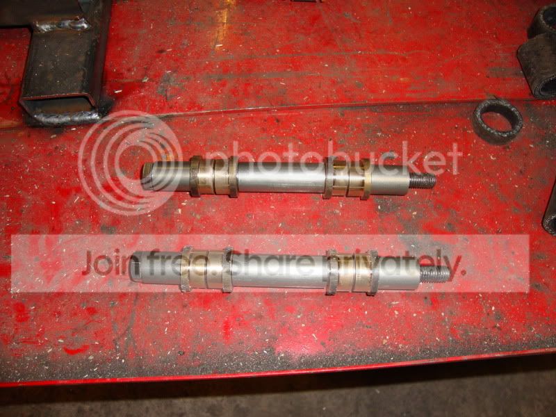

Well as promised I have done some work on the Honda but it doesn't look much for 3 Hours work.
I pulled tha Back end off the Bike and Started making some Spacers for the Rear Shocks.
The original rubber bushes are spliting already so I will make some new ones out of Phosphur Bronze to fit these stainless spacers. Hopefully I can find some PB tomorrow then I can switch the Lathe off for a bit.
I've been putting this job off for a while because it is so boring.

My Lathe is slow esspecially when working with stainless so I have to psych myself up for these little jobs. Hours of work and small Parts at the end.

I've nearly finished making the Shock bushes now. Just got to work out the outer Lengths.
Gona try and think of something a bit more fun to do next.

Today I put a bit more time into the swing arm adding some more strength.
It doesn't look much but it took most of the afternoon. I wish I had taken some pictures of the internal gussets. It is total over kill but it won't fall off!!
Still a load of blending to do but hopefully it will be finished tomorrow.
