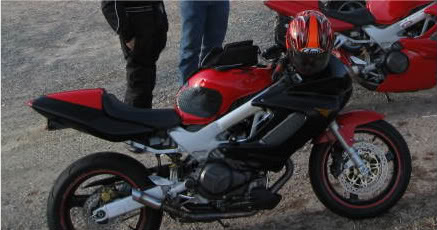

Post 'deer incident' I'm prepping the hawk as a streetfighter conversion. Bucket headlight, no fairings, etc. In line with that theme, I'm looking to cut weight and extra crap as much as possible. The stock cans and passenger pegs look like prime real estate for some weight savings, and a way to clean up the rear of the bike similar to how I'm cleaning up the front.
So here's what I'm thinking. Take a set of spare cans I have sitting around, and lop off the whole can. Cut the weld just before the pipe necks up to the diameter of the main exhaust body. After doing that, weld a short (max 4") extension that angles to point the short exhaust parallel to the swingarm. Install a baffle in that extension to cut down the noise and get some backpressure back. This would allow me to remove the entire stock cans and the passenger peg hangers, which would clean up the rear and save a BUNCH of weight.
That said, do y'all think I could get enough backpressure back from baffling the extension pipe to make this only moderately insane? I realize it'll be loud, but hopefully not stupid loud. I know what it sounds like w/ just open header, and I'm thinking if I can get to half that I'd be happy.
