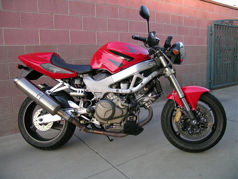

Thanks for the compliment, blokeontheend.
Here is a recent pic of mine.
Kai Ju

Still my favorite naked VTR.

Yeah.... that's a good one.... Moving the rads is key on the "naked" bikes... would love pics of the rad location and how he did it...

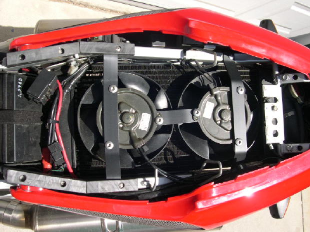

What did you do with the radiator?
Old Nov 26, 2007 | 06:12 PM
kai ju's Avatar
Joined: Jun 2005
Posts: 524
Smile What did you do with the radiator ?
Wait, are you telling me this thing is watercooled ?
All you have to do is disconnect the temp gauge and it stops overheating..............
All joking aside, the radiator is living happily under the seat, where it belongs.
Kai Ju

One of the best mods on the forum and says it works good in SoCal. Is that a stock oil cooler up front?
I agree with the others - you go naked you must deal with the radiator issue. They are just butt ugly on the sides without the fairings.
