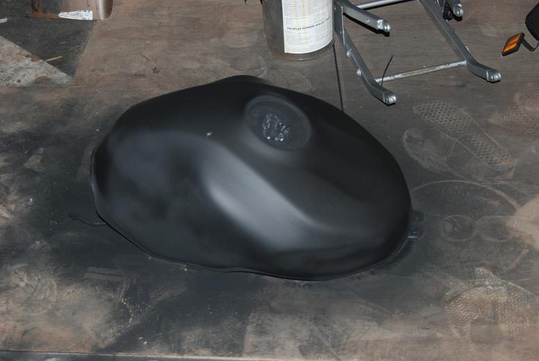

Here is a pic of where I am at so far:

So... how are you going to be sitting... like, upright like a cruiser/chopper? where are you relocating your battery and electronics to? there's not many places left on the bike for you to stuff them lol

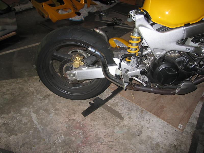

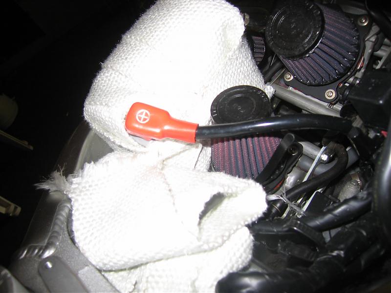

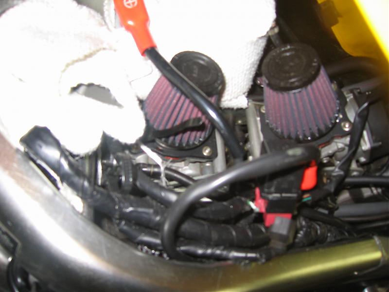

Thanks for everyones interest... progress so far... It's not a whole hell of alot b/c I started this project without a clear look in mind, so I spend a ton of time drinking beer and staring out... if i drink too much I start crying like a baby...what have I done what have I done.
- Air box is out an cannibalized for to use as brackets for air filters that will be mounted under the tanks. I basically cut out the plastic bottom area that match the top of the carbs and then machined a metal piece that matched to mount the air filters to. I'll attached a pic later.
- K&N filters mounted on carbs and smaller ones for the crank case vents.
- Wiring and battery stuffed under the seat wrapped them with fiberglass fabric wrap - at least thats what I am calling it. I am not sure how hot it gets under the tank, but I figutred better safe than sorry. BTW there is a sh#$ load of room under the tank once you get rid of that air box.
- Cans are off the bike and upp for sale on Ebay. i am keeping the Jardine pipe exentsions as they follow the tire line well. I do not plan to put pipes on the bike sounds too friggin good without them.

Updated pics

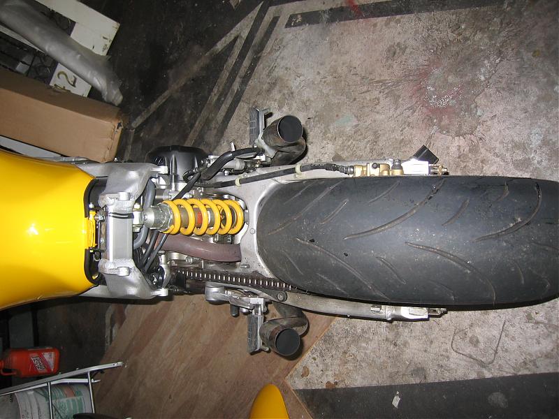

I figured you guys need to see how the hack jobs was coming alongs so I am trying to post some pics. All the wires and battery are under the tank, wrapped in fiberglass fabric wrap to keep some heat off it and make the battery fit snug and prvent damage from rubbing. You can also see how I mounted the air filters. Tons of room under the tank when you get rid of the huge air box.
Attached Thumbnails Custom Superhawk - beyond street fighter-img_0022.jpg   Custom Superhawk - beyond street fighter-img_0023.jpg   Custom Superhawk - beyond street fighter-img_0024.jpg   Custom Superhawk - beyond street fighter-img_0025.jpg

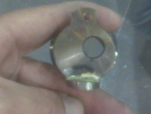

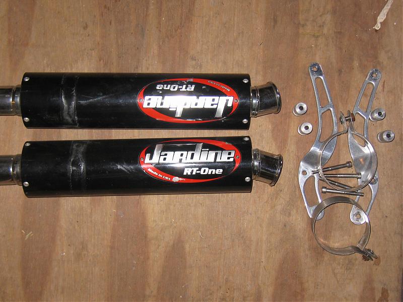

pics of parts for sale
i have attached some pics of the parts I am selling. I hope that it is not against the rules to put linke to the ebay auctions. If it is oh well, I've done worse things in life... The auctions are ending today! I will be putting other parts up tonight like the corbin seat, tank bra, seat cowling, and what ever else I am not using.
1. Pipes - I am keeping the mid pipes/ extensions. The logos are scuffed up, but the rest is in good condition
Honda VTR 1000 Super Hawk Jardine High Mount Exhaust
2. Rear Fairing
1999 VTR 1000 Super Hawk rear / seat fairing
3. Front and side fairings - The left side has a crack in the bottom section of the radiator opening.
Honda VTR SuperHawk Front & Side Fairings with lights
4. Fender Amp to fund project - need to pay for rear fender, front fairing, and new helmet to match the new cool style - see pic
Fender Twin Electric Guitar Tube Amp w/case 100 watts
Some other things:
1. Anyone have a cafe racer front fairing they want to sell? I found a perfect one on ebay, but lost the auction. So far nothing else has come up that is the exact look I want.
2. The helemet I pictured is from Europe and not approved in the US - What is the difference in the standards bewteen the US and Europe. Safer here or there?
Attached Thumbnails Custom Superhawk - beyond street fighter-picture-003.jpg   Custom Superhawk - beyond street fighter-picture-006.jpg   Custom Superhawk - beyond street fighter-picture-012.jpg   Custom Superhawk - beyond street fighter-af9f_1_b.jpg

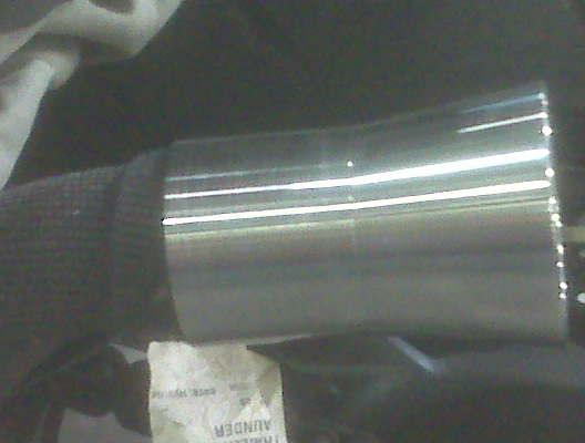

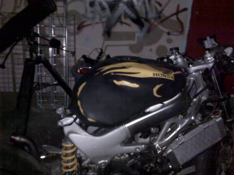

Ok a quick update on the progess of the project. Not much... had lots of traveling to do so I have minimal forward movemnet...
1. Finally found a cool headlight off of ebay. I got a headlight off a ATV from the 80's. Its a ectangle shape with the metal grill. Looks tuff.
2. Start to black out the bike... I had this cool idea to keep the honda logos and turn them into yellow flames on a black tank. Taped off the logo and flame shapes and then painting the rest black. After a few layers of black, I'll paint over the logos and flames and then sand them back out for a tuff used look.
I did try to run the bike down the street, got it to start with out the pipes and all the wiring under the tank. I put the old tail frame back on and salpped the seat on adn felt cool as hell for the first 1/4 of a mile until it stalled and wouldn't start back up. sucked having to push the SH back up a slight incline. Without the pipes the bike needs a little adjustment to run longer than a minute.
It is pretty loud, but I wan't able to get on it to see how obnoxcious it really is. I am tying to find a way to keep the look and tone down the sound.
Enjoy the pics.
Attached Thumbnails Custom Superhawk - beyond street fighter-img00007.jpg   Custom Superhawk - beyond street fighter-img00010.jpg   Custom Superhawk - beyond street fighter-headlight.jpg   Custom Superhawk - beyond street fighter-dsc_0003.jpg

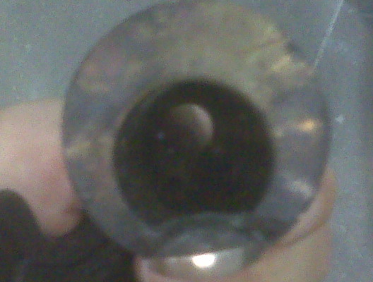

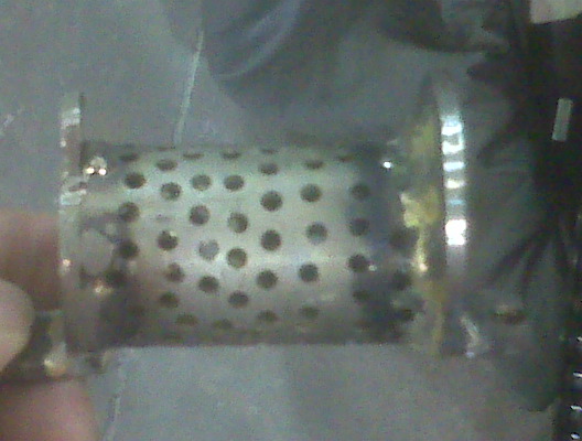

Update - Lots of pics
OK lots of updates:
1. Made some custom stainless tips for the pipes. In the process of making some ploppers for the ends for the mac truck look.
2. Made some baffles for the pipes to create back pressure and cut back on the noise a bit. The pipes are now loud, but not over the edge. It sounds greate. If you notice there is small off center hole on one end of the baffle. The is a swinging cover the can open over cover the hole to make a slight adjustment in sound.
3. Pipes wrapped black
4. Seat - old scubbed backpack. Fits perfectly. Mounted to eisting seat breackt holes with a custom seat frame. It will eventuall get some padding and a leather cover.
Attached Thumbnails Custom Superhawk - beyond street fighter-img00041.jpg   Custom Superhawk - beyond street fighter-img00042.jpg   Custom Superhawk - beyond street fighter-img00043.jpg   Custom Superhawk - beyond street fighter-img00045.jpg   Custom Superhawk - beyond street fighter-img00044.jpg
